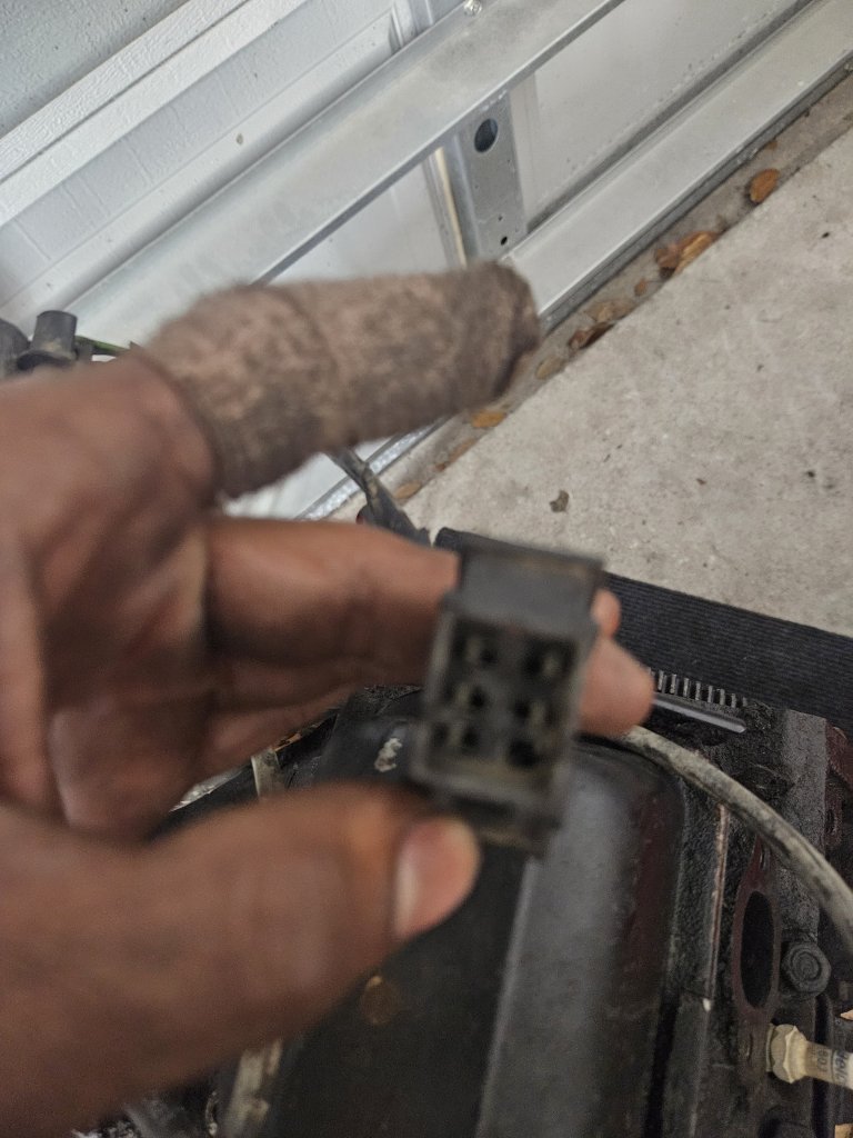

Doing and engine swap in my 85 burb and I have no idea what this is or what it's for can someone please help do I really need it??

Cruise control vac actuator valve. It's what holds your throttle linkage in place when you set the cruise.

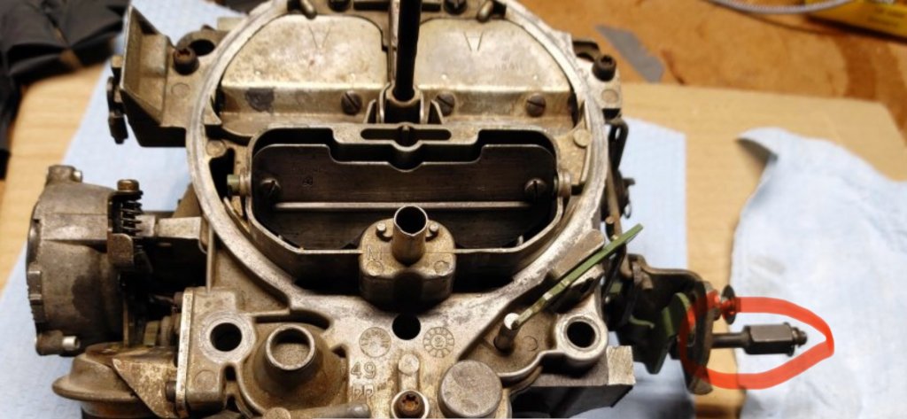

Jawzjeep,
Could you post a pic of your truck’s cruise control linkage connection that is under the air filter, attached to the carb’s throttle body linkage?
That’s my last piece of the puzzle for my cruise control.

Jawzjeep,
on the bottom.

Do you have a pic of the connection bracket to the carb where the cc actuation rod makes contact with the throttle linkage?

PrairieDrifter:
Thank you.
I don't. I never used mine. It's just a little pin like how the throttle cable would attach. The hook goes on the actuator and the slide part goes over that pin. So when the throttle actuates, the cruise pod doesn't interfere with the linkage, except when engaged.
Redmanreaction
Jul 7, 2023
LV NV
Red
K20 Scottsdale
Gotcha.
I’ve seen a couple ‘vague’ pics of that pin assembly.

Found pics of the cc rod that I’m looking for.
