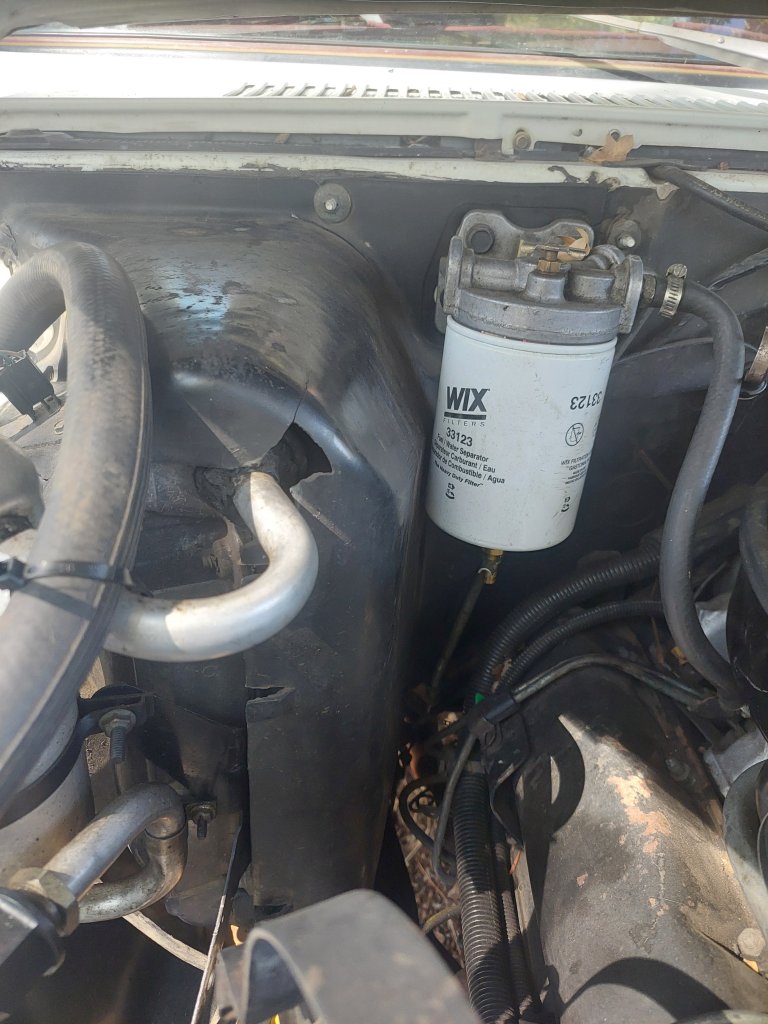

K5 Blazer
6.2l
There is an AC exchanger cover on the firewall and it is covering the heater studs, and I can't get at the nuts. Do I have to totally remove, that is destroy ( it's very brittle), this schroud to get at my stud nuts out?
Richard B
Sep 6, 2024
Richard
K5 Blazer
6.2l
The answer is it has to come out in pieces. If you don't want to disconnect the AC components. Well now it looks like the ones that are not diesels. I guess that will do.
