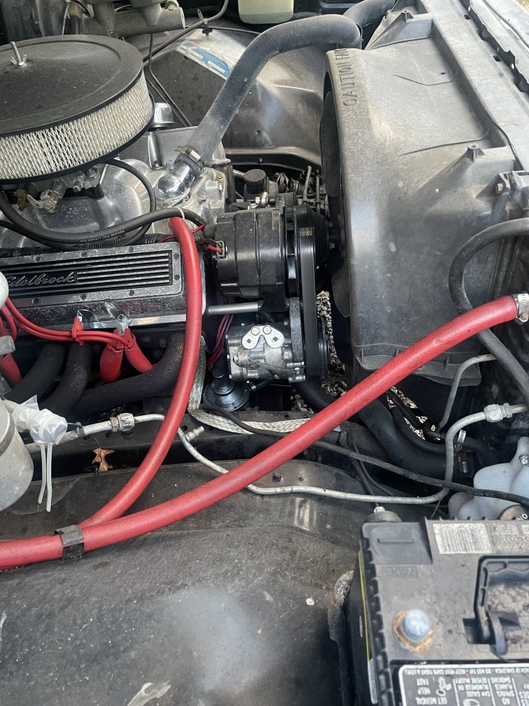

Yesterday at 11:43 AM #1 Jtobe81 Junior Member Joined Sep 29, 2024 Posts 12 Reaction score 4 Location las vegas First Name Justin Truck Year 1981 Chevrolet Truck Model c-10 Engine Size 350 What is the correct heater hose routing from the engine to the heater core? water pump to core or intake to core.
Yesterday at 6:56 PM #2 Rustisbest Super Access Member Joined Jul 20, 2021 Posts 254 Reaction score 725 Location Athens, TN First Name Matt Truck Year 1979 Truck Model C10 Engine Size 377 5/8" hose from the intake to the lower heater core inlet 3/4" out to the pump or the radiator
