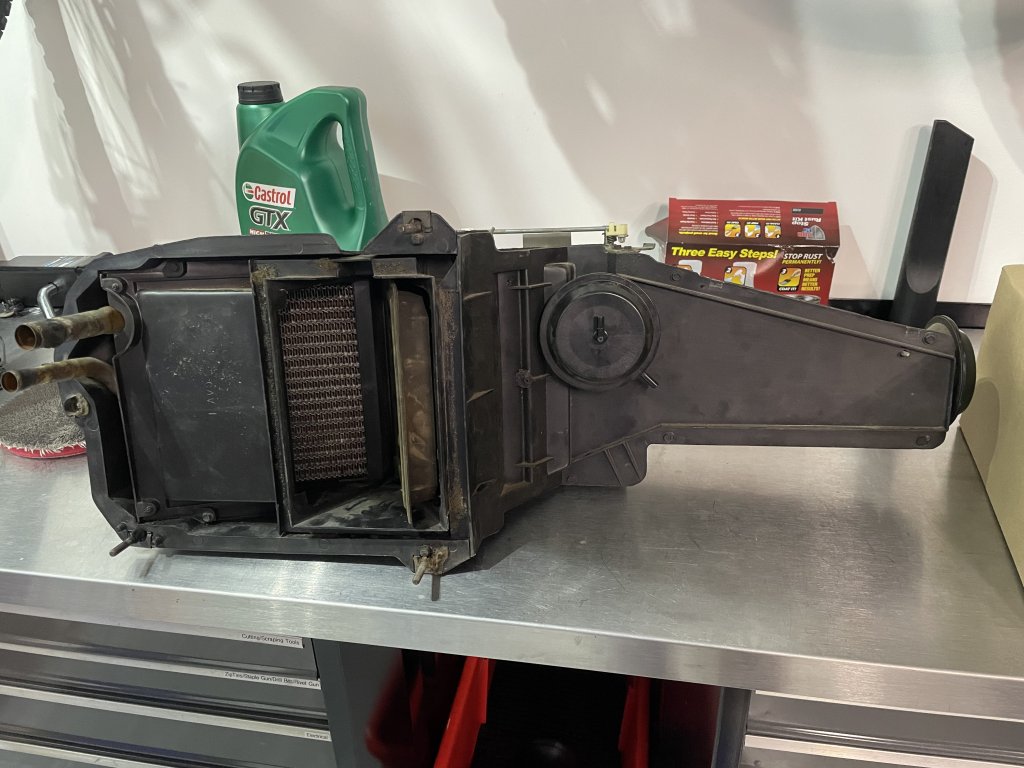

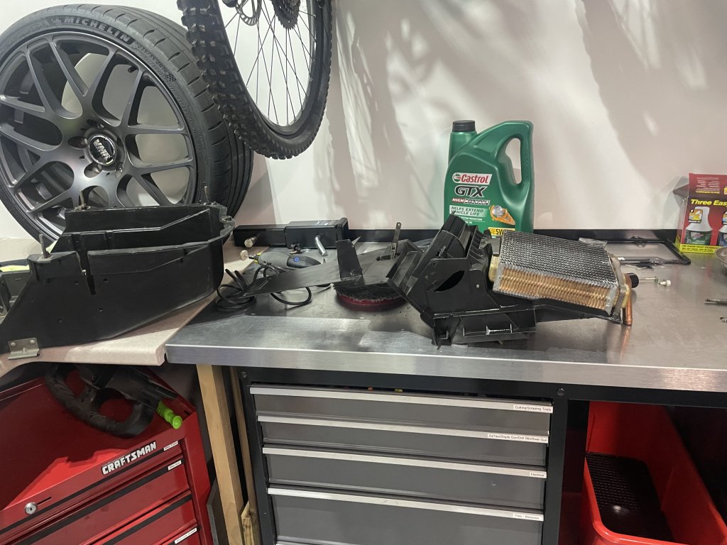

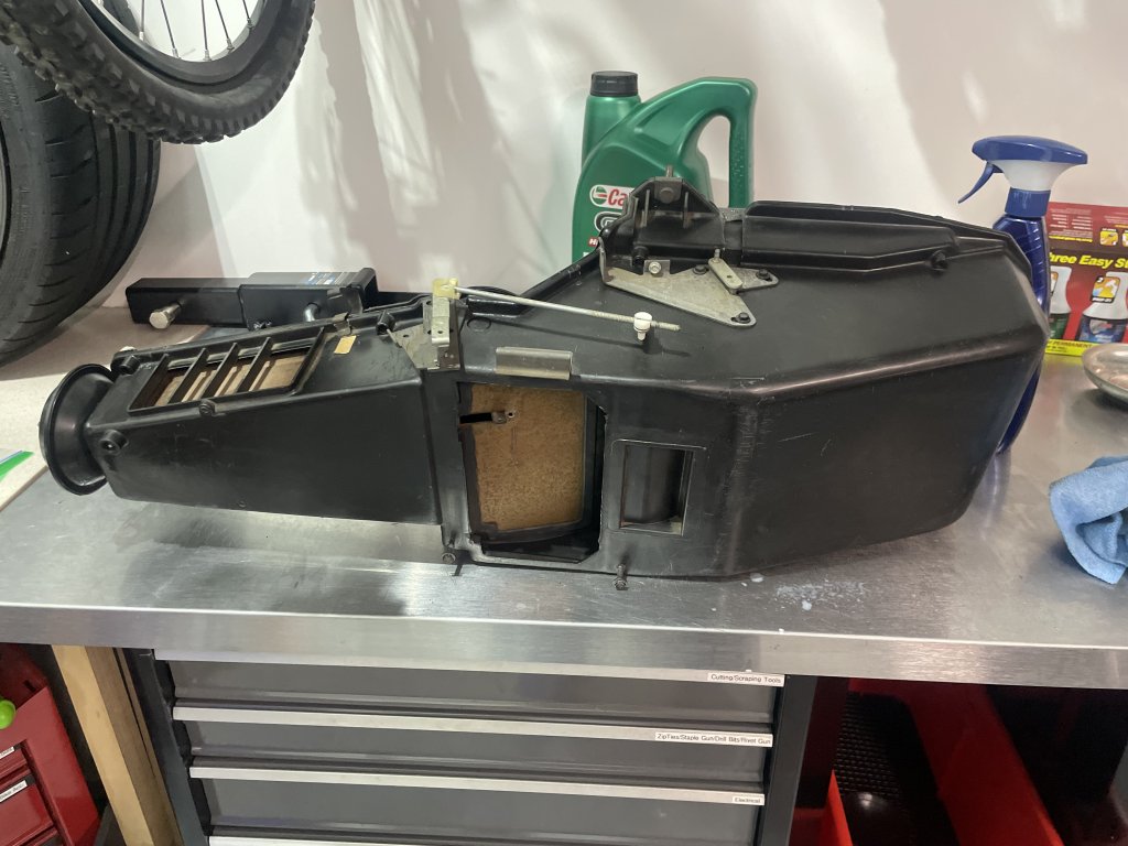

Box came out pretty easy. I got it split apart and the new Summit core fit nicely. Buttoned her back up with the aluminum blend door latch and pin (thanks for that pointer—the original definitely broke as soon as I touched it).
I have everything cleaned up and ready to go back in the truck. Now I just need some free time to reinstall everything.
