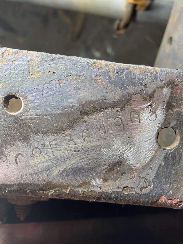

I am having the exact same problem. This was on top passenger side frame behind cab. It reads c9f364903. From the identification chart’s posted I’m guessing it’s a GMC. Any assistance is appreciated.

he only thing coded into the full VIN would be the engine option. Trans, axle ratios, etc are not coded in the VIN.
The partial VIN on the frame gives the nameplate (Chevy vs GMC), model year, final assembly location and the sequential portion.
The VIN is stamped on the top of the frame rail (not the side) in one or two locations. No crossmembers get stamped. There's the VIN on the cab and some assembly plants (Oshawa in particular) would stamp a partial VIN under the heater box for some years, not all. Engine and trans get a partial VIN, not the axle(s). The SPID label is the equivalent of the old body tag.
@pkiller
Chevy, 1979, probably last place was manufactured at was Flint, Michigan.

Thank you very much. The title says 1981 c10. I am looking into getting new leaf springs, but apparently they differ before and after 1973.
