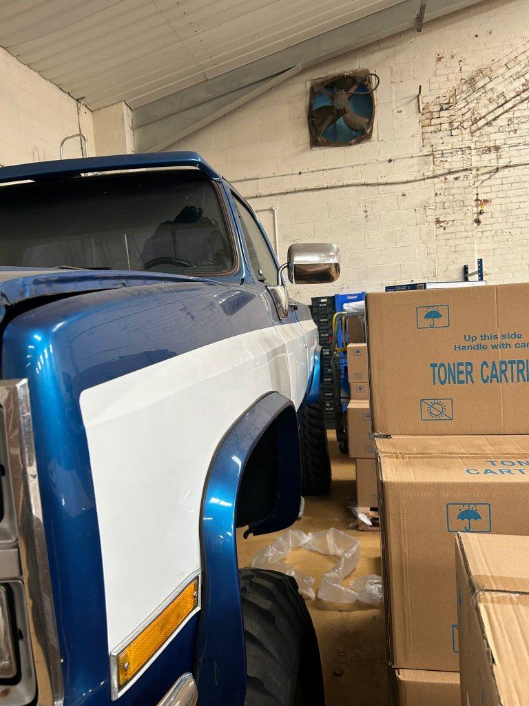

TBH, i just wanna get home. Get pics and get everyones opinion on if its an original chassis.
The joys a being a “long distance” truck driver. I say “long distance” because the miles we can do are nothing compared to in America.
Photos I have so far, courtesy of my wife.
Quite hard to get a decent photo as its quite close to a wall and has shelving, boxes and pallets stacked around it.

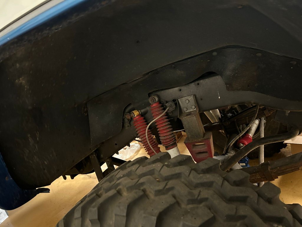

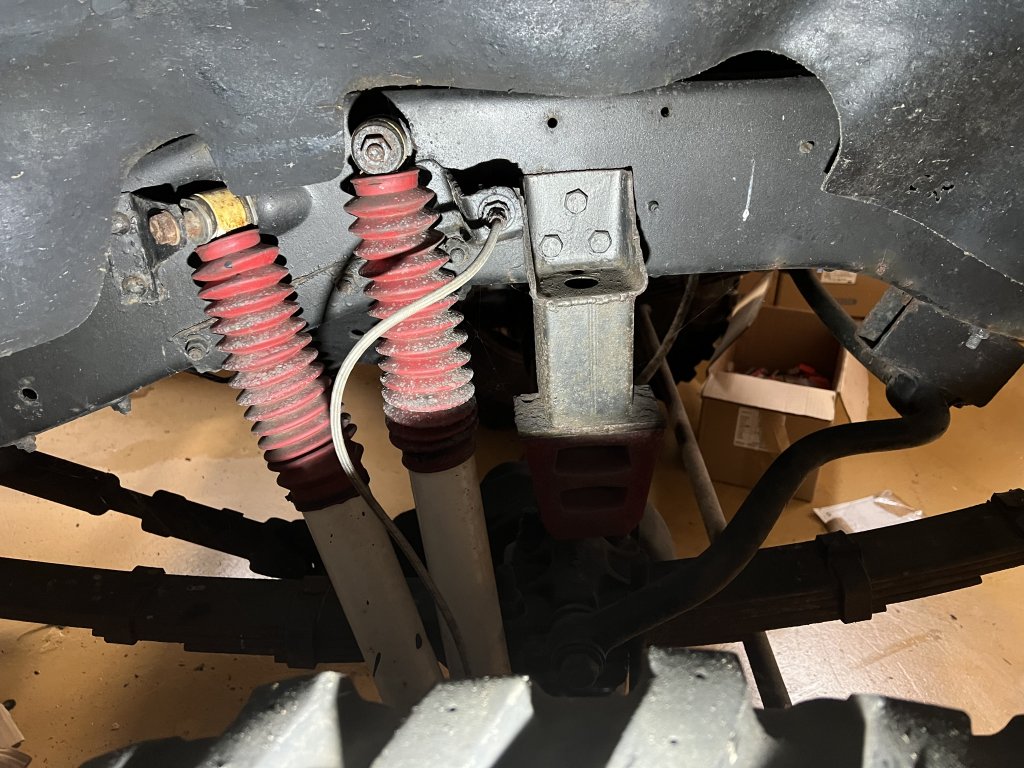

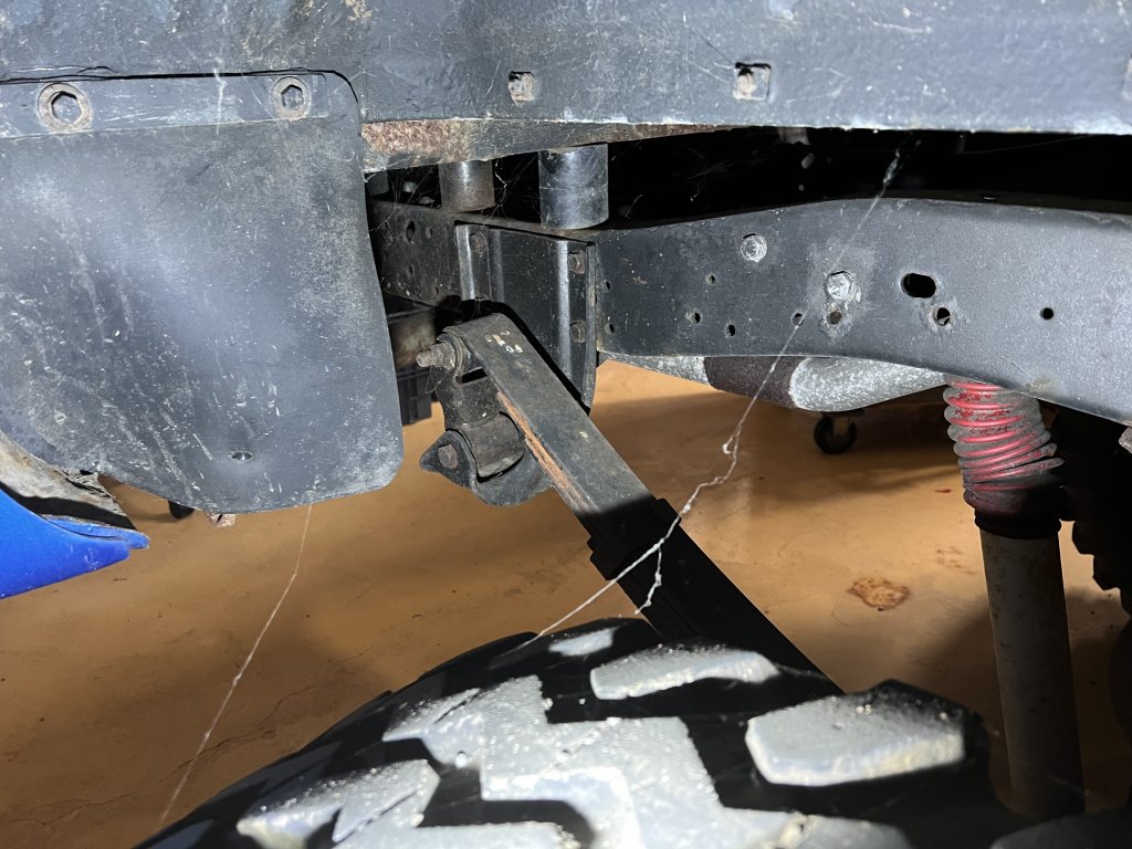

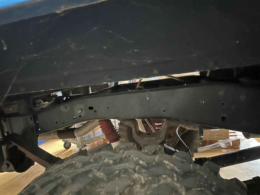

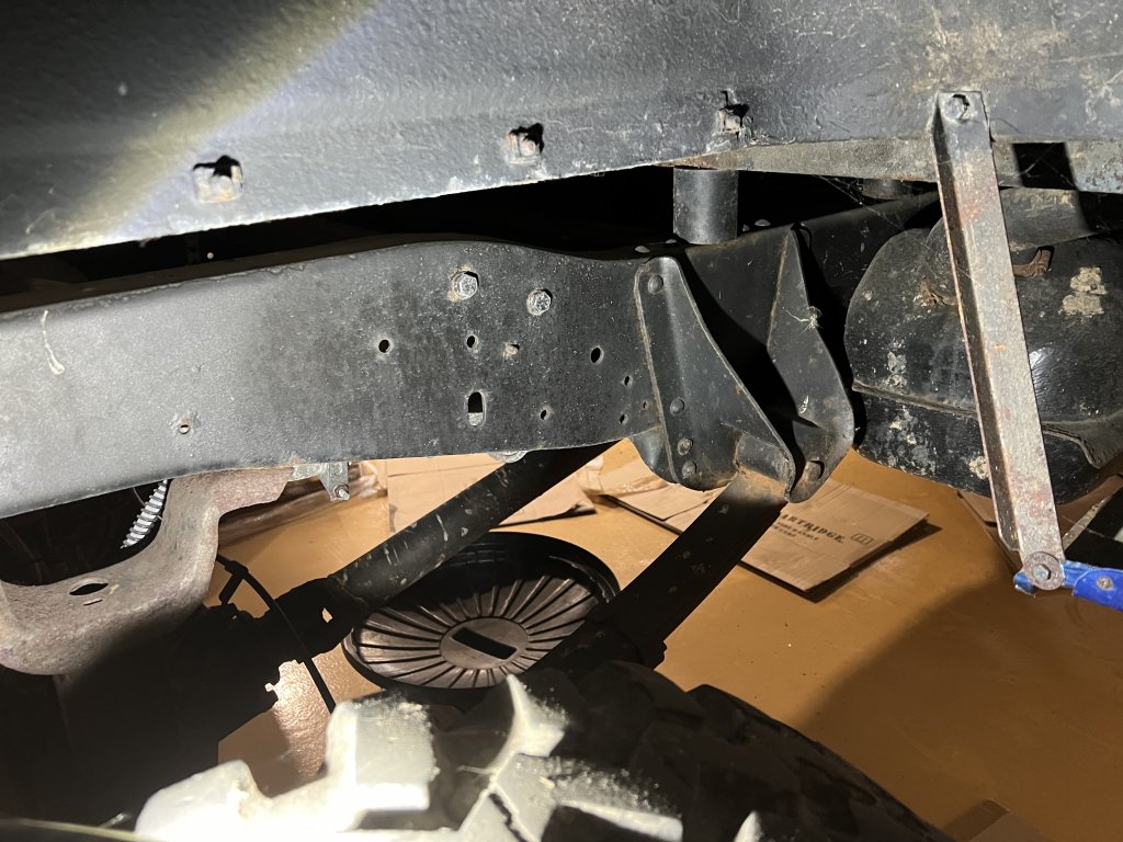

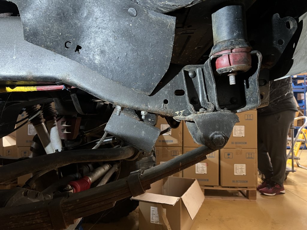

Hoping pics of the spring mounts will help someone confirm what it is.

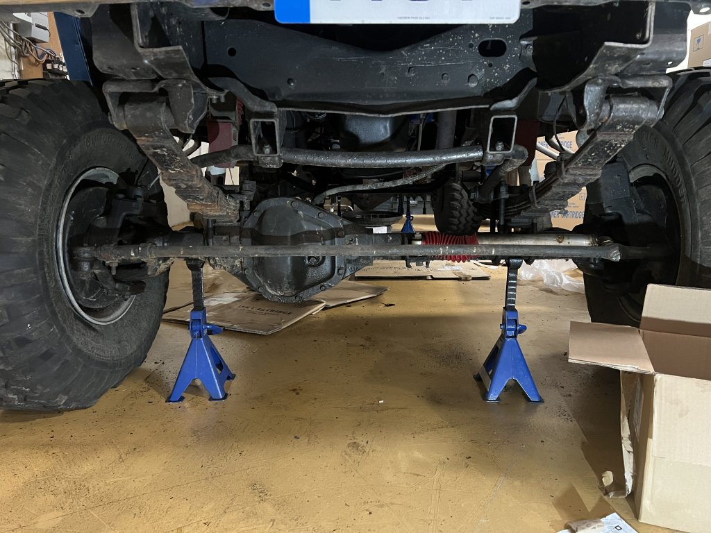

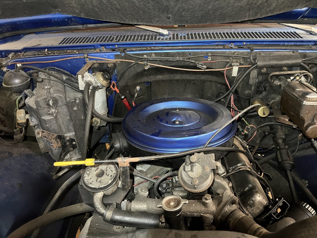

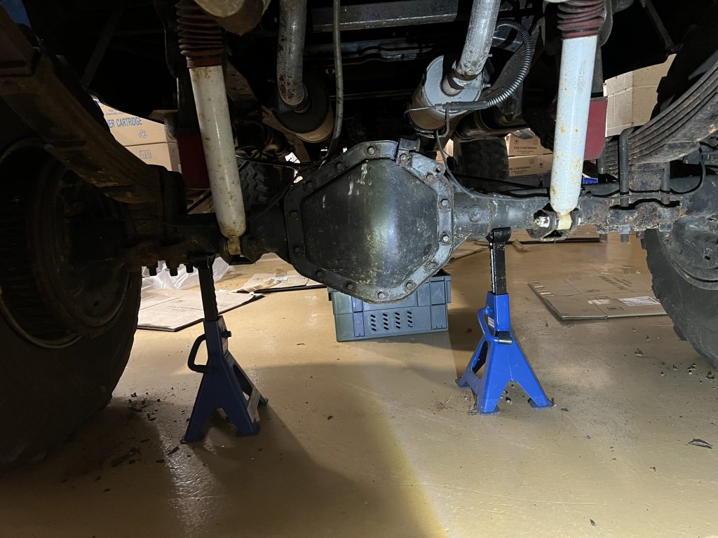

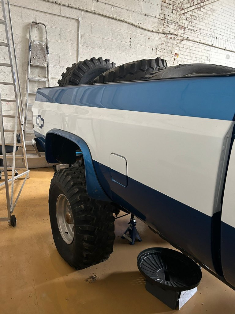

More random pics.

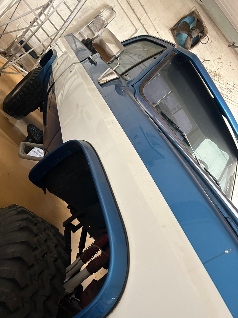

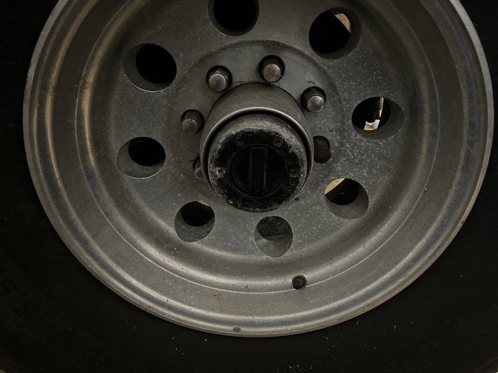

Not sure about where all the parts came from but that appears to be a factory 4-wheel drive frame.
It also appears that you have a Dana 60 one ton front end and a 14-bolt one ton rear end. Great combo of parts. But I think its safe to say you have a Frankentruck. I hope you can get it all documented and have fun driving it.
The axles did confuse me, especially having the 8 stud hubs.

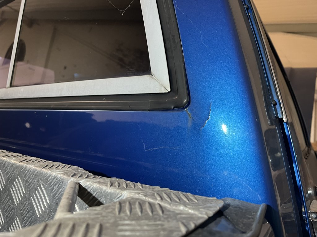

I'd be concerned about the crack in the cab near the corner of the rear window. Might be Bondo or rust under that paint; paint can crack from extreme temperature shifts too.
