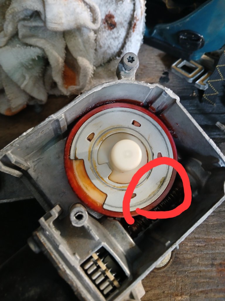

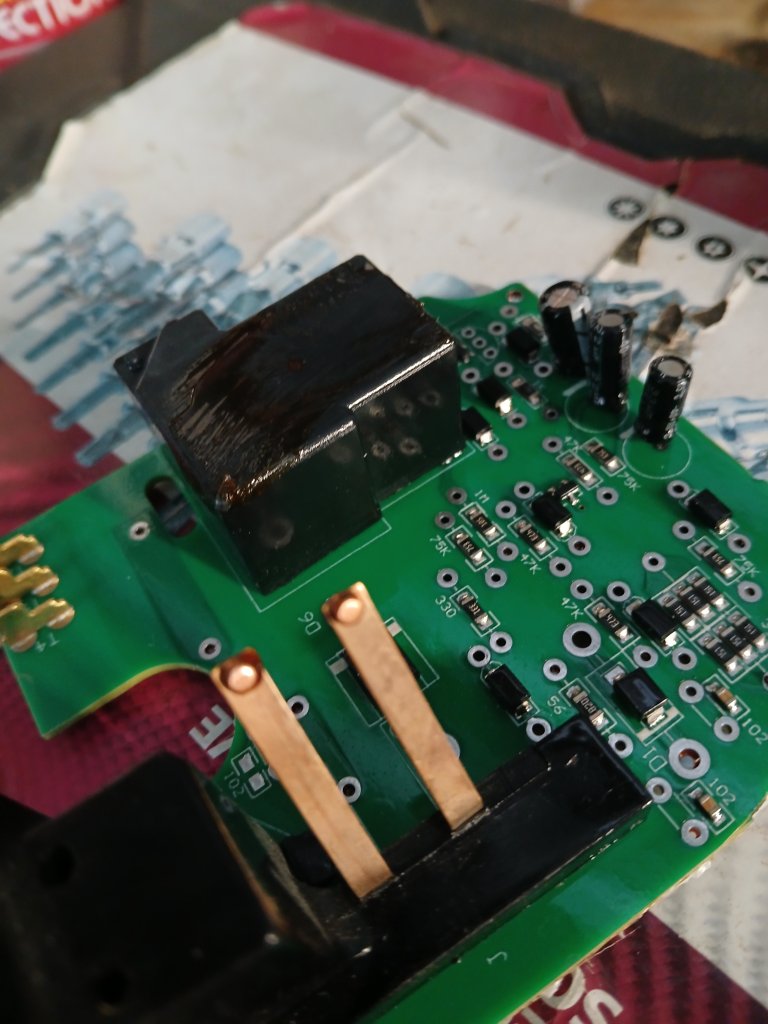

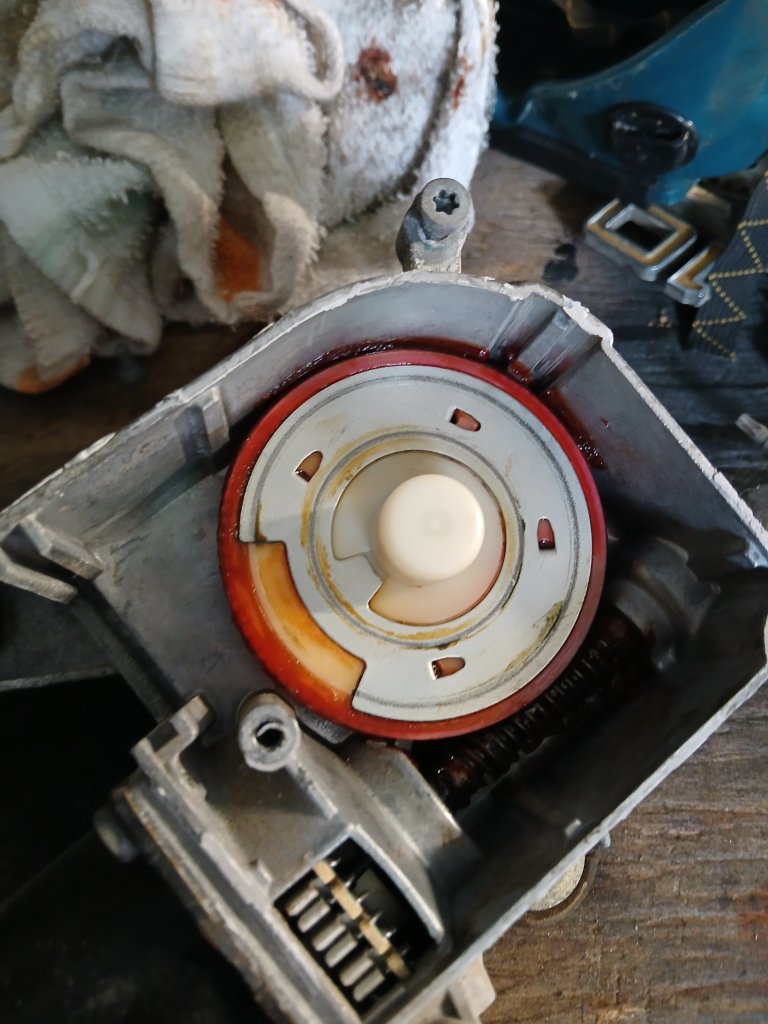

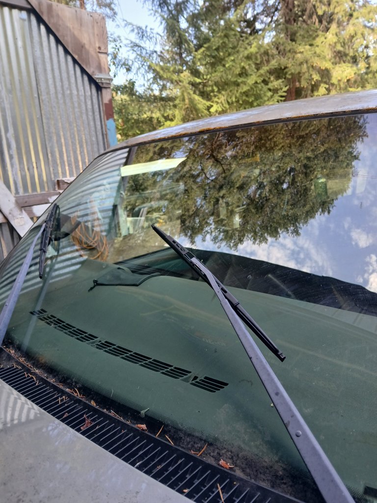

Hey everyone, 1999 k1500 suburban,had been sitting since 19. wipers were doing wonky things and so I replaced the pulse board and it'd acting better but has trouble going to rest. If I fiddle with it just right I can get them to park but once I use them again there back to resting up high. I did not remove the motor so I know I didn't mess with linkage geometry. Any ideas on how to reset motor? Or is there a problem inside the motor?
