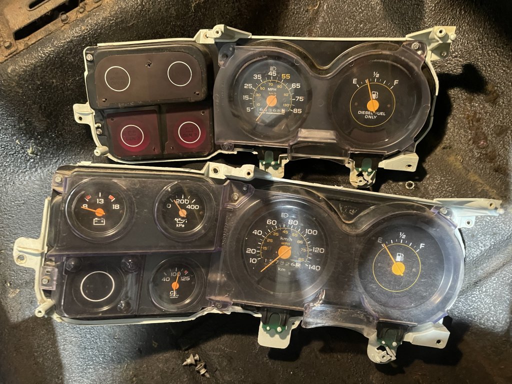

I just swapped over to gas from a diesel that had been in storage since 2005. I also switched the gauges as well since I had both and didn't want "Diesel Fuel Only" on the current gauge.
Anyway, the sender is reading out some and needs to be replaced. It shows 1/8 while empty and 5/8 with 9 gals in it. Both the old diesel and replacement gas gauge read the same.

I've got gas sending units in my diesel, so vice versa should not be a problem. Difference in part numbers is due to 1, 2, or 3 ports. Only difference between a 3-port gas or diesel unit is the plug for the "water in fuel" light on the diesel.
