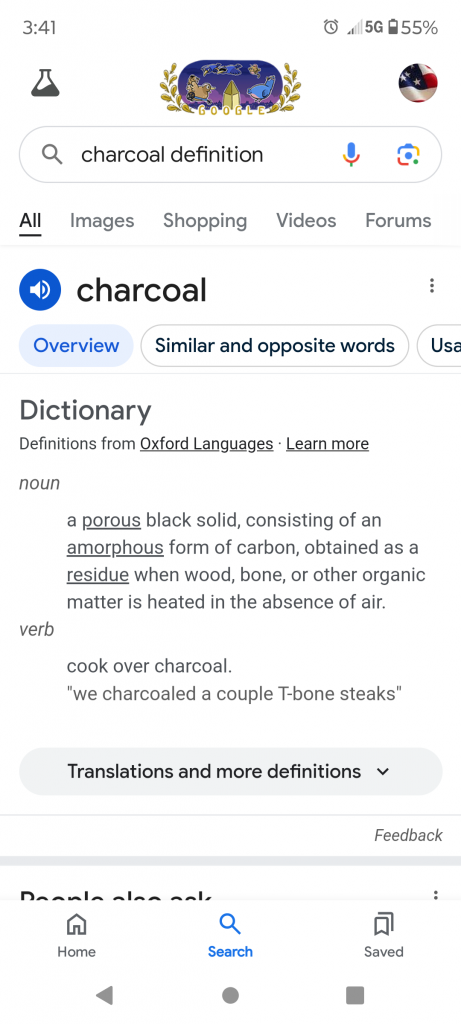

Smart!

In what form? Burnt wood or some other form of incinerated substance?
I have used charcoal from fish tank filters before (new not used). It comes in a fabric bag and seemed to work to remove soldering fumes sucked through a small fan.
