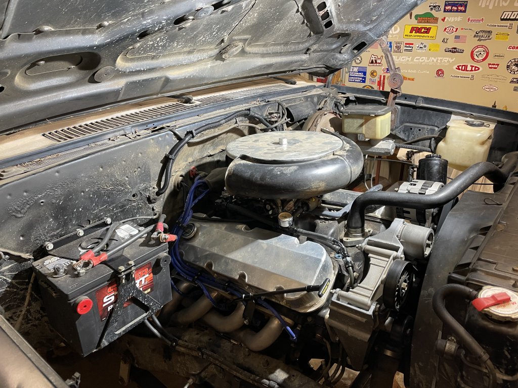

Yeah… my Blazer didn’t come with a 454, the quadrajet fed by the electric fuel pump or the SBC serpentine belt conversion but I made lines that worked, crazy. It’s all about how bad you want it to be “right”, you could always just lay a bunch of rubber hose across everything and hope it works good.
