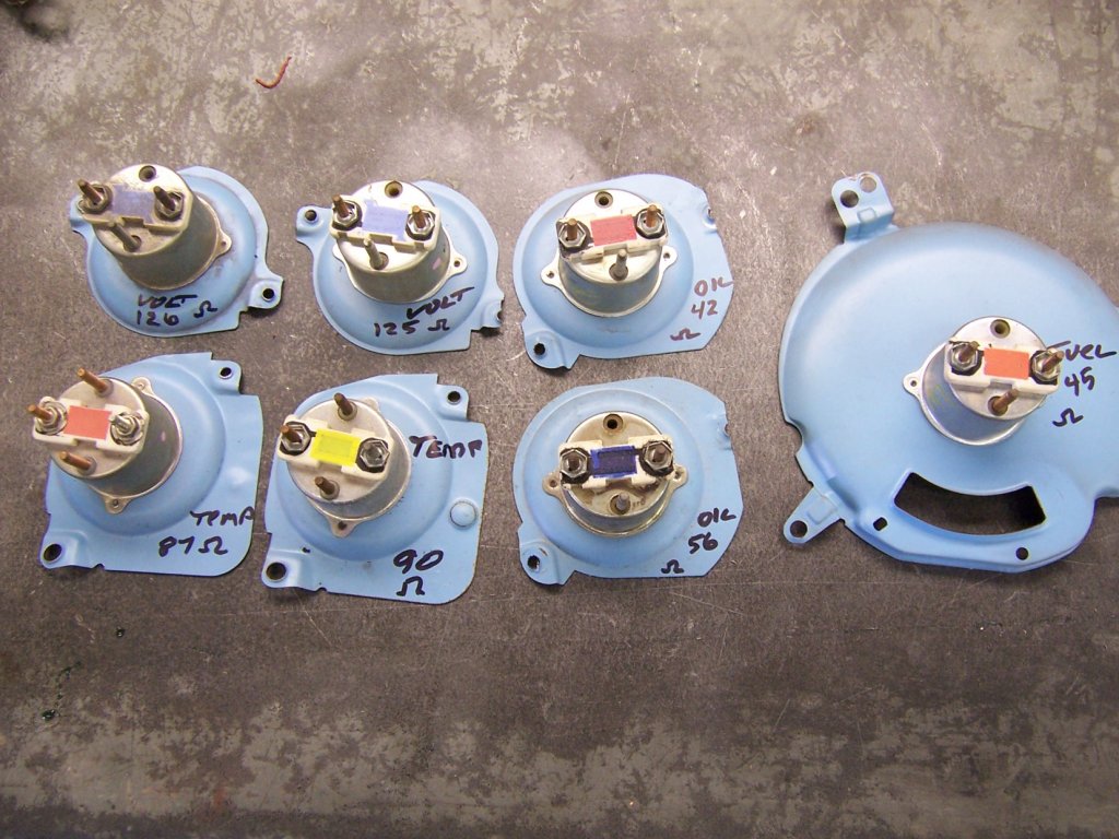

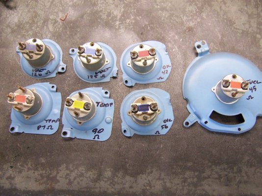

Have several loose gauges. Quick ohm check [not isolated] mostly confirms the Hatzie post.

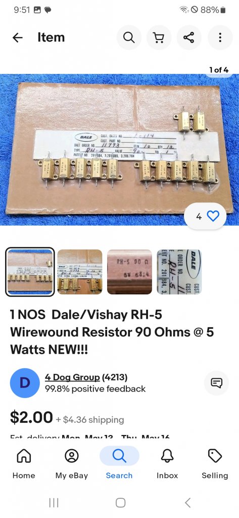

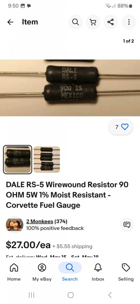

Just found these. Would either work?
