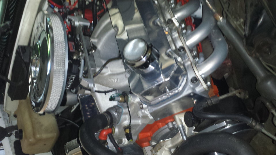

Just installed a 1200 hp unit on my truck. The temp sensor was a problem with mine. Would read 20 degrees cooler than my guage. Got a new one for a 97 vortec 350 and problem solved. There are some adjustments I had to do to my afr settings to get the surge to stop during cruse and acceleration . Had to make my own adapter so it would mount to my dominator intake. Other than that it's a real tire shreader.

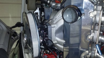

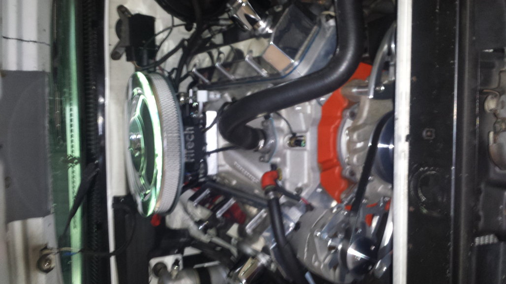

I'm using an aeromotive 340lpg, 90psi fuelpump. I installed it in place of the factory in tank pump. 3/8 supply line and 5/16 return. My truck is a 92 so it was easy to make the change.
