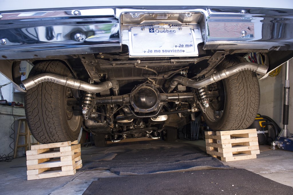

just did mine myself ...and i'm not a welder but its ok and save me lot of $$$ :)
Nice, I like how the tips are only poking out under the fenders. The exhaust I have now terminates after the mufflers just before the rear axle. Probably keep it that way.
