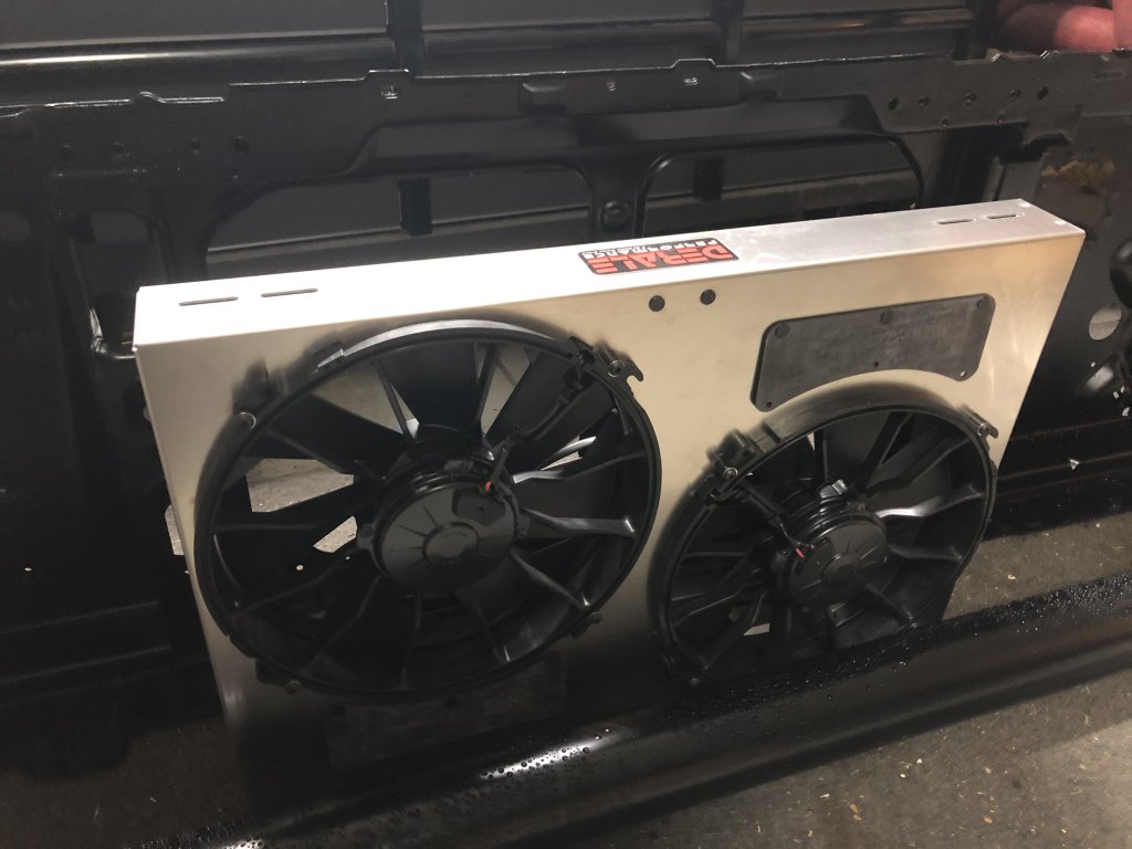

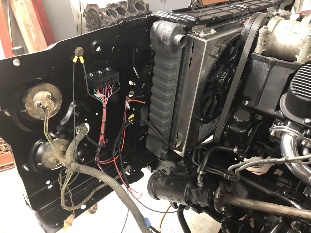

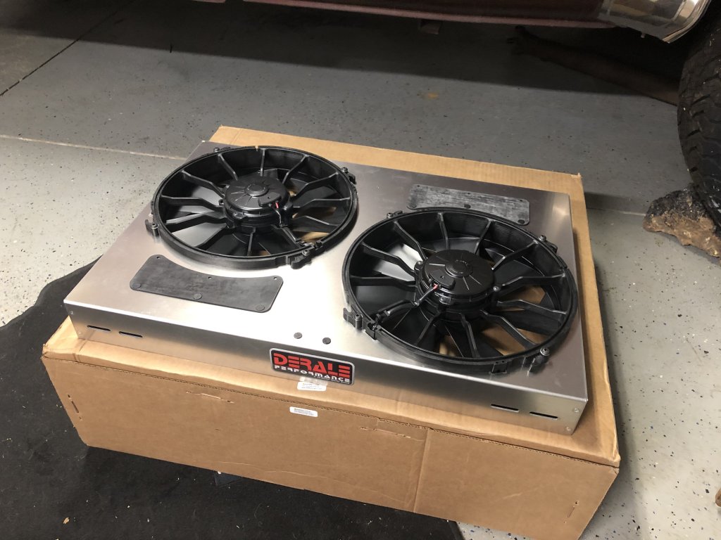

I went with Derale brand for my 82 C20 with a 454 V8, was able to order with a size shroud that fit my radiator perfectly, added a painless install kit with relays & works great! Keeps that built BBC nice an cool on those really hot days! Using stock 4 row radiator btw.
