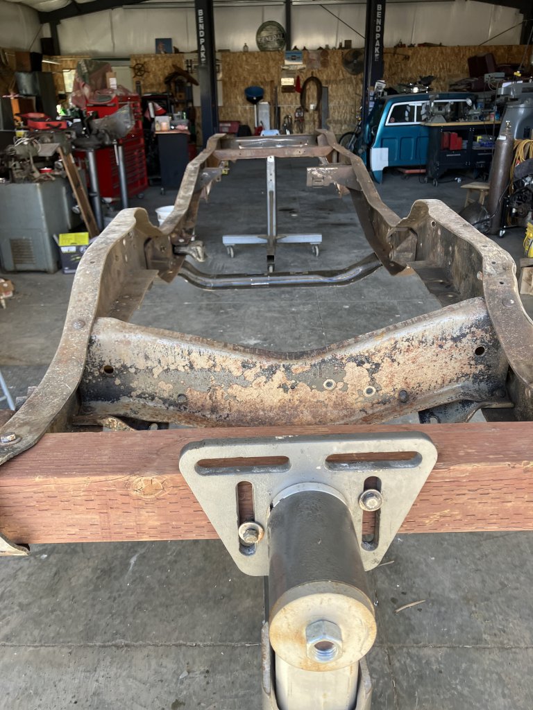

FINALLY starting the first stage of reassembly, painting the frame. I'm tired of not finding someone to blast the frame, so I'm going to do it myself in the driveway.
Once I get it "clean" (no old flaking paint, it's not very rusty so I'm looking for a good surface for the paint/coating to stick) I will be putting it back in the garage and starting the process with a metal prep and paint/coating/topcoat as needed. This truck will get plenty of use, so I want to protect it as much as possible.

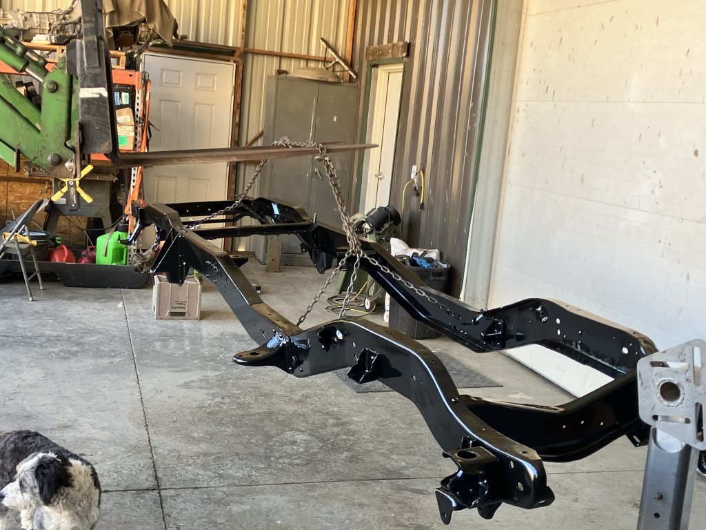

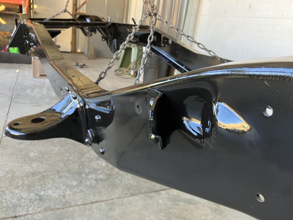

Wire brushed my frame, degreased, black epoxy primer, Magnet Chassis black, on clear coat, but I should have, ran out of time. Used POR15 on the 55 panel engine bay, completely chalked out in five years, repainted after prep with Duplicolor and has worked well.
