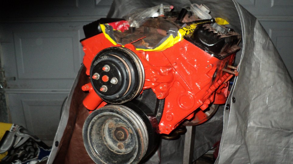

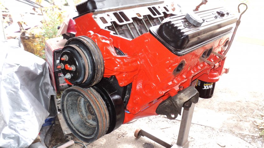

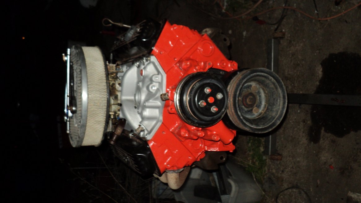

Stuck the balencer on and a couple of pullys and painted the water pump bolts. Cue-tips work wonders when painting bolts.

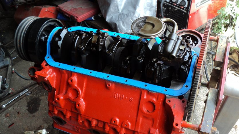

Todays Progress:

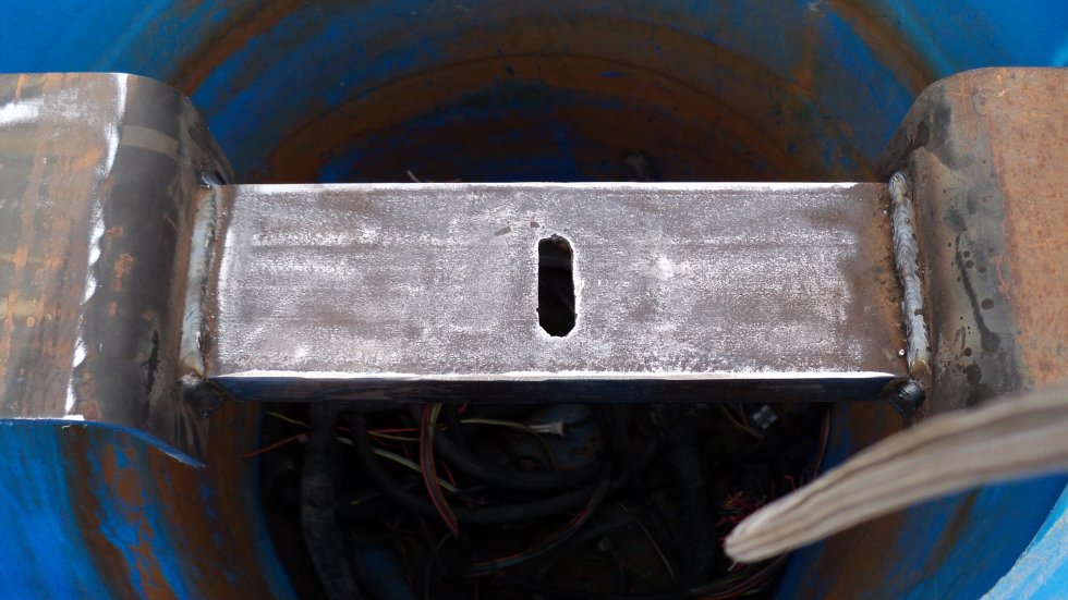

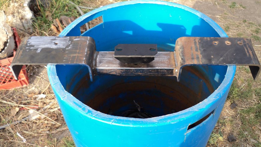

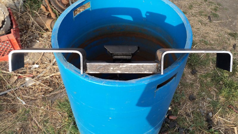

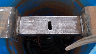

I just realised i hadnt shown you my crossmember yet.
I need to get the engine and trans in before i can finish it, but here is how it sits
10" Channel for the exhaust loops, and 3" channel for the actual trans pad.

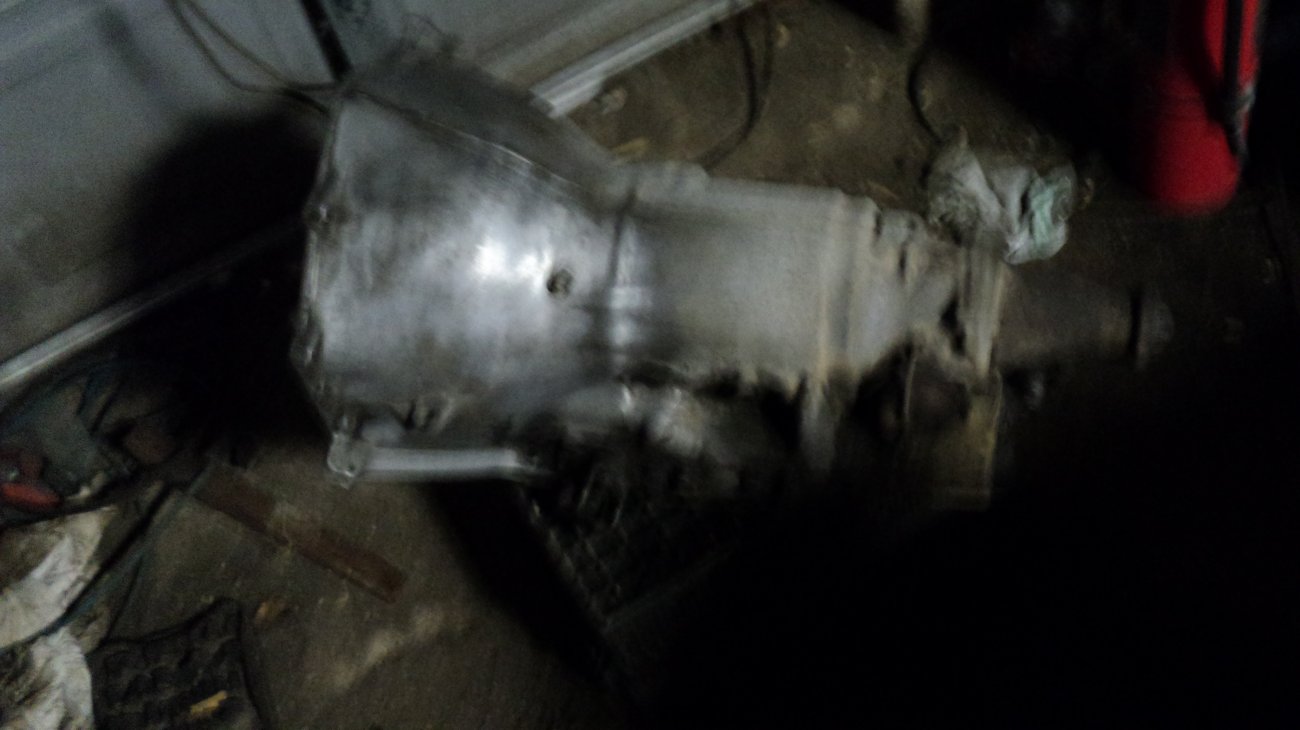

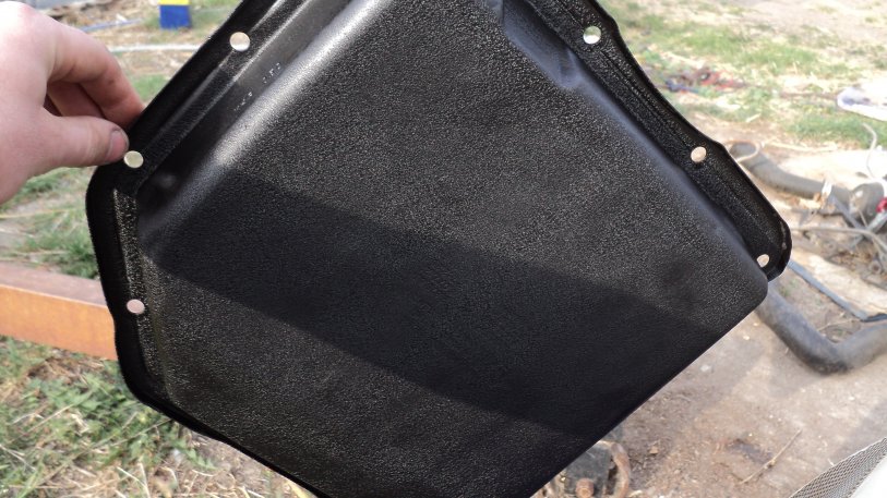

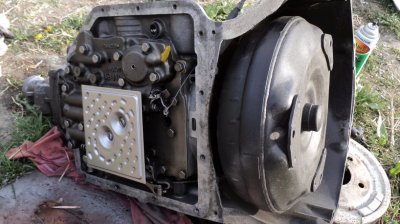

And for an update on the trans
Sorry i dont have a current picture, right now its all buttoned up ready to go in. I ended up painting it high temp silver.

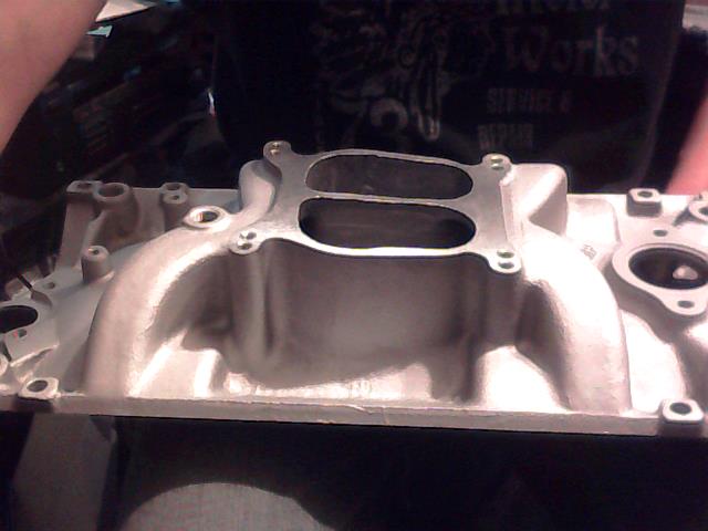

guess what santa brought me today.

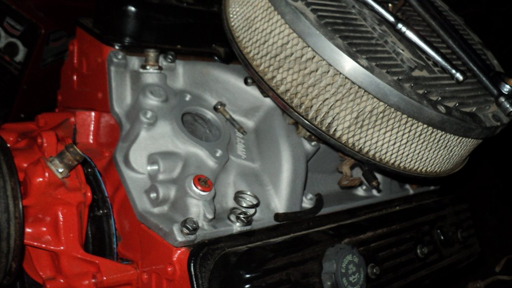

I WAS THIS ******* CLOSE TO MAKING MY DEADLINE (I I)
But local parts stores have to special order my intake gaskets. And they will be here thursday, THURSDAY, the last ******* day of school.....
Tomarro im gonna try one last place and hopefully they have one, if not theres no way ill make the deadline.
Anyways, heres what i got done today(intake is just setting on there)

Damn! You almost wonder if a dealer parts counter would have them and not cost an arm and a leg.
Felpro #1255, its intake gaskets for aftermarket vortec intakes

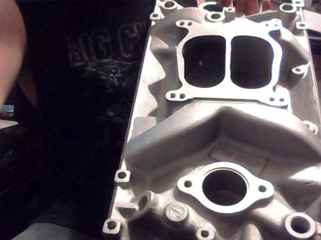

:idiot: Santa doesn't come this time of year for one, and two, the fat bastard doesn't exist. If he did, and brought me a Pro Comp intake I'd whip his ever livin' ass for bringing me that junk.
Well OK, maybe they're NOT ALL junk, but just a tid bit of info and awareness so you'll KNOW TO CHECK IT. Those Pro Comp intakes are China built. It's very common that the runners DO NOT line up with the head ports very well, or they're very small. When you get your gaskets, flip that intake upside down, and match the gaskets up to the intake and see what you have in reference to how they fit the head side too. There's been several vac leaks that could never be found on users of Pro Comp. All said and done, it was the intake with mismatched ports. And then there were the ones where a guy could do some of his own porting and clean them to where they matched and fit pretty good. Just sayin', check out the fitament before you just slap it together. This common issue was several years ago, hopefully those ricers have gotten the mold casting figured out right now and they're better. Otherwise, if you get one that fits right, or make it fit right, they don't perform bad at all.
