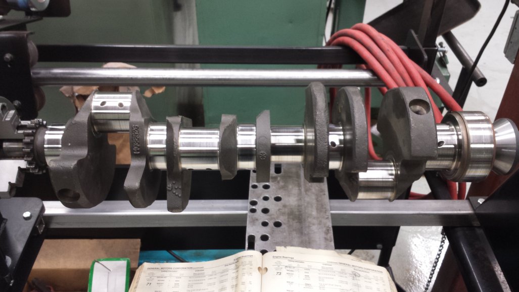

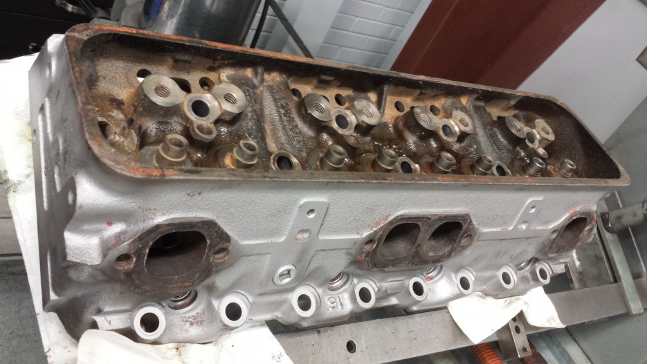

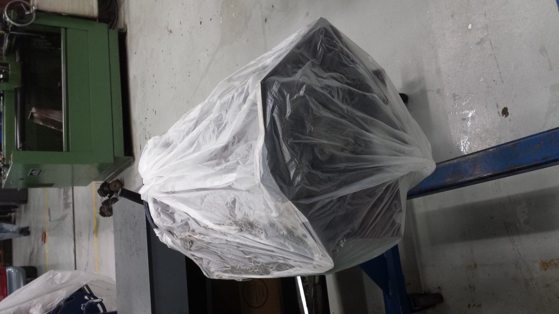

Update: Been doing most of the machining for my engine.
Block, Check
Heads, Check
Crank, Check
And the tin is done
Going roller this time. And pics are on my phone, so ill have to add them later.
Goal right now is the end of june.
And ill get an updated pic tomarro, the engine block is painted.

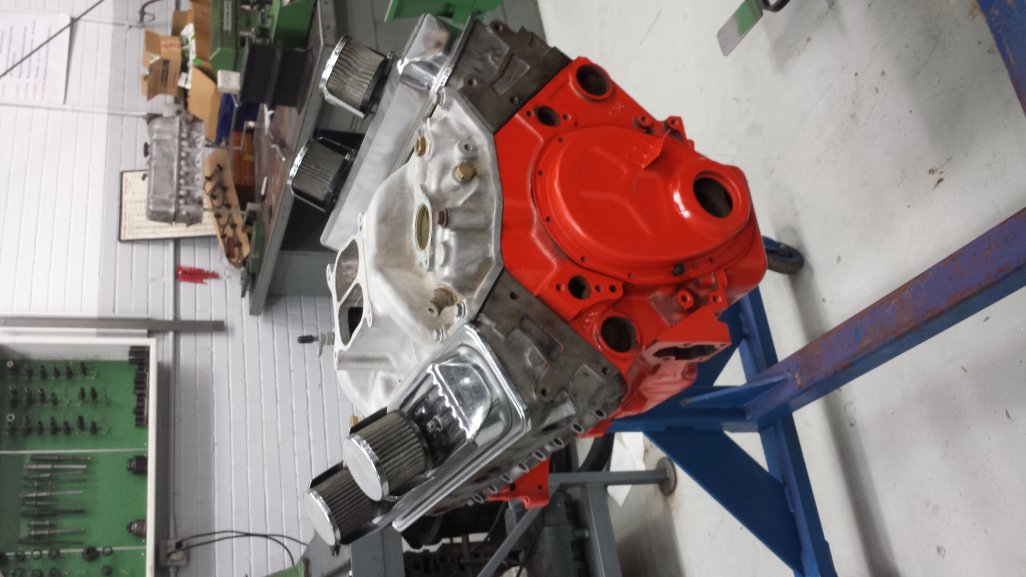

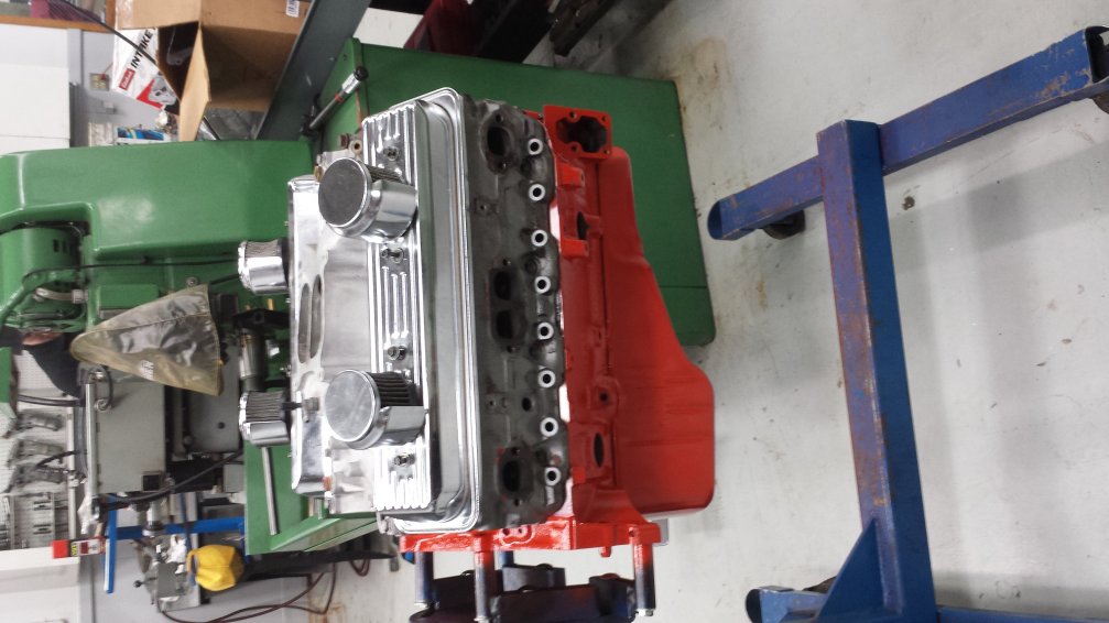

Did a mockup friday. Valve covers arnt mine. They were the only ones around atm.

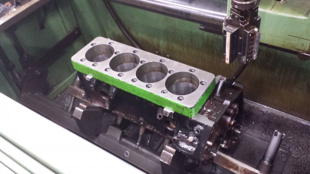

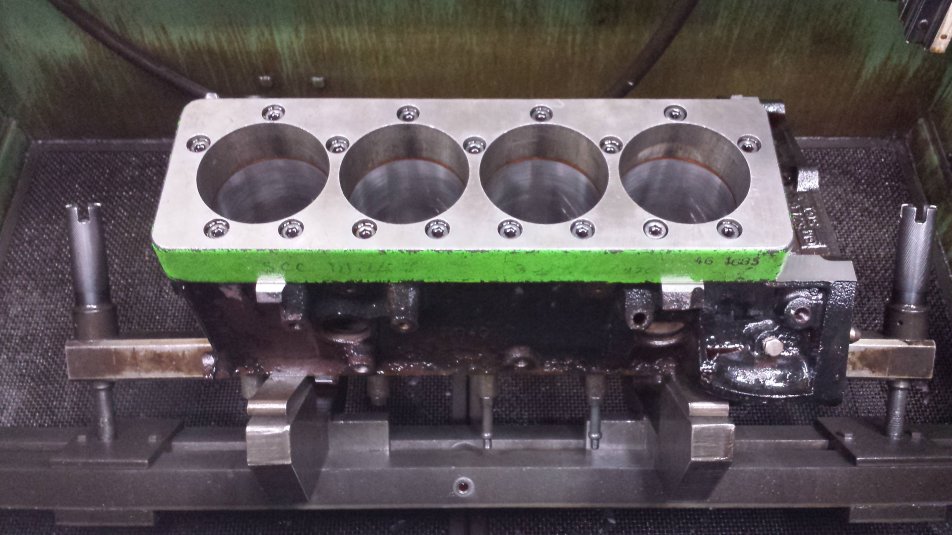

That's a top notch bore job right there. And clue what the green thing is and why for it's used? It's not always used.
Driver4r
Jun 21, 2012
3,087
40
Nebraska
Trevor
76,74
k10,c20
Thanks. I did it all myself.
It's a deck plate. It basically preloads the block when you bore it. The metalergy inside the block thinks the heads are bolted on. So when you bolt the heads on its perfectly straight.
Deck plate vs. Non it's not a whole lot of difference. But I think it's like .001-.002 out of round if not used.
And I wanted it PERFECT.
And for those who are following this. I actually went .031 instead of. 030. Who can tell me why?

I was wondering what that plate was for, now I know. Makes sense. We didn't have one when we rebuilt my engine, but it was a re-ring rebuild on mine.

I actually went with a roller block this time around. It's cheeper than a retro kit. With a retro kit you will have the run the link bar style lifters which will run you about 4-500. Then with a cam that let's say is another 4-500. There's 1k already.
So unless you run a small base cam (.900) the oem roller blocks and lifters will do the job.if you run a small base cam then your back to the link style.
But small base cams are for BIG lift. We're talking like 750+.
But all in all. In a retro kit it's the roller cam bushing(if gear drive timing), the link bar lifters, and the cam.
And as for the deck plate. If a machine shop does it. I was told it's like 150-200 more. Just cause it takes more time to setup. And the gain is minimal unless your building an all out performance engine and need every ounce of power you can pull.

Both. I'm running coated skirt pistons. But the coating is only like .0002 thick total.
Mainly it's for expansion. Again mainly a performance thing. Usually most places just go .030 for standard use. And .0305 for performance. But since it tends to run hotter in the summer and I run it HARD and test limits. I put a full thousands of extra clearance in for expansion.
99% of .030 pistons are .027-.028. Cause they have pre determined the expansion
