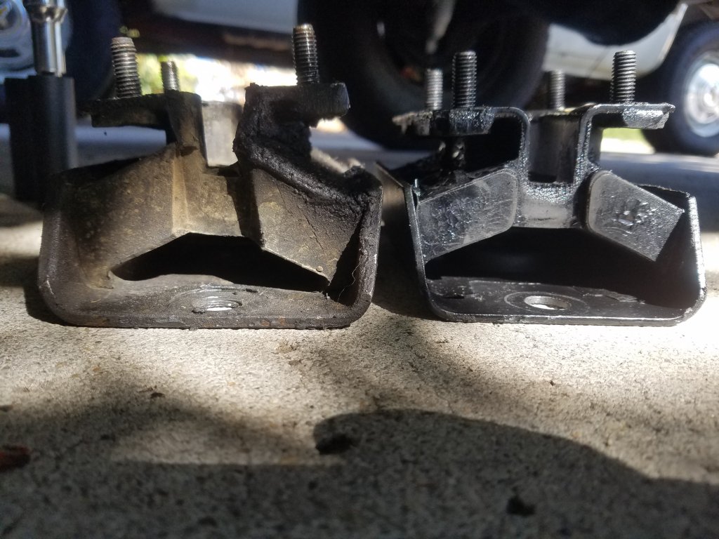

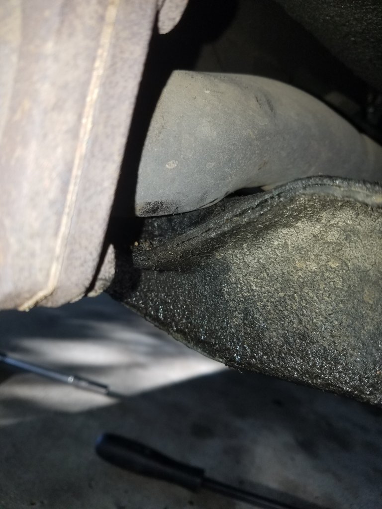

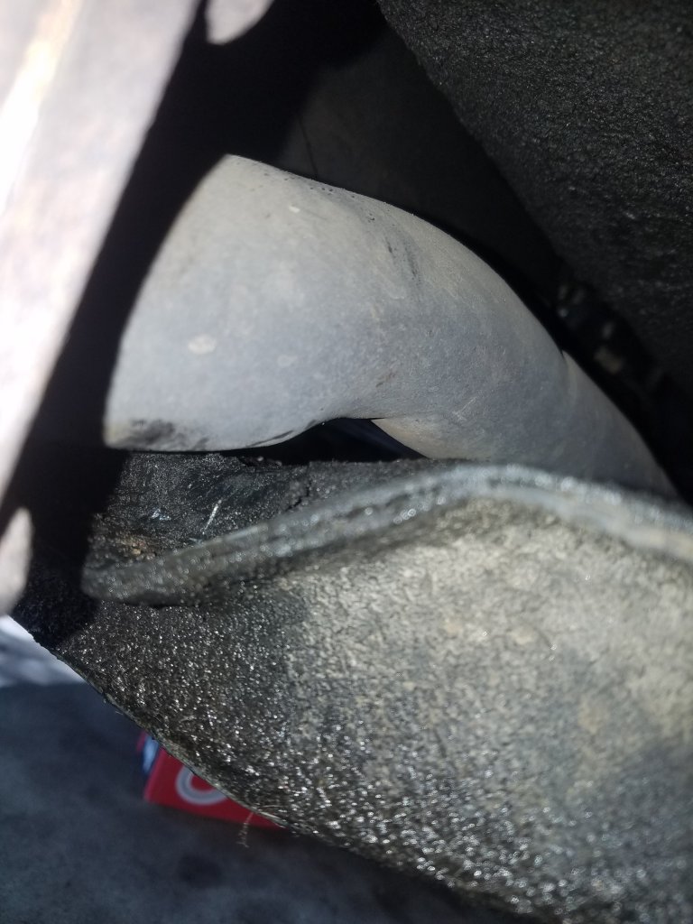

Transferred the photos. See what I mean by the big difference in exhaust pipe clearances and the old vs new mounts.
With the new mount the exhaust pipe had no choice but to bang against the crossmember, whereas, it never had before, never. Not even with the worn out engine mounts, did it hit anywhere from the header to the rear hitch. Reinstalled the old mount and instantly regained the correct amount of clearance so the exhaust pipe didn't hit crossmember.
