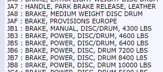

My question: the parts store is asking if I have a JB1 or JB3 braking system. They can’t tell me the difference, this is a Frankenstein truck, and the RPO sticker is long gone.
It’s a 81 GMC 1/2 long bed 2wd, originally 350 Olds diesel powered. The factory Hydraboost system is long gone.
Can anyone in readerland tell me what I have, or tell me what to look for? Thanks.
