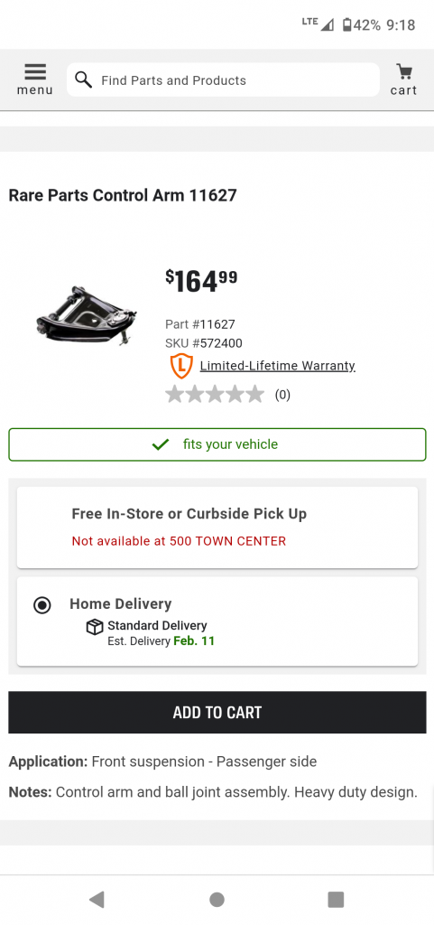

autozone mentions "heavy duty design"

I don't like to deal with autozone, and if the arms are $165 plus tax each, I will scrap out the truck.
It's the truck in the avatar pic I have.
Shame a nice rust free truck goes away, but crap happens.
