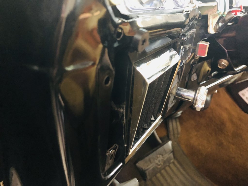

Got a project truck, 78 big 10 with gm dashpad in box.. none in cab. Also got new ac vents. Driver side vent fit is my problem. There is a tab on upper left that sits forward 1/2 inch. Afraid i’ll break it off . Any clue as to what i am doung wring??

You might need to put the vent in first. I forget the order of how I did mine.

the picture may not be clear enough to see the tab on upper left; do you think the vent assy belongs behind the whole metal dash??

I'd try it behind the metal. The vent is missing from my parts truck, so its a definite maybe.

Thanks, that was it; mount screw it up to the metal dash. This truck has been a Lego set assembly with no instructions… but its cool now! Thanks again.
Start the vent under and behind the dash. Approach from behind.
