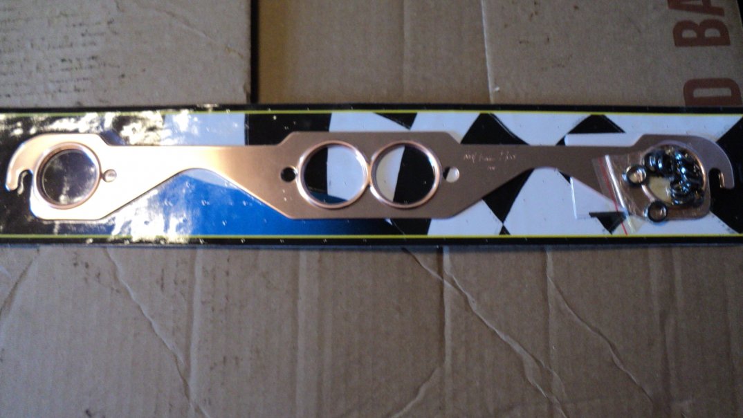

I bought myself a Pair of these for my monte, and so far they are excelent.
Alot of people swear they seal better than the aluminum, but these are a prettier penny. So I guess it just comes down to how much you want to spend.
A pair of these is $50. And the matching collector gaskets are $22
And im not bashing the aluminum ones, cause i havnt ever used them.
Kinda like the embossed ports on those who makes em?

Was just about to ask the same question lol

you know felpro makes metal coated header gaskets. they are what I run. that one in the pic looks real thin on the outside sealing surface. highdesertranger
