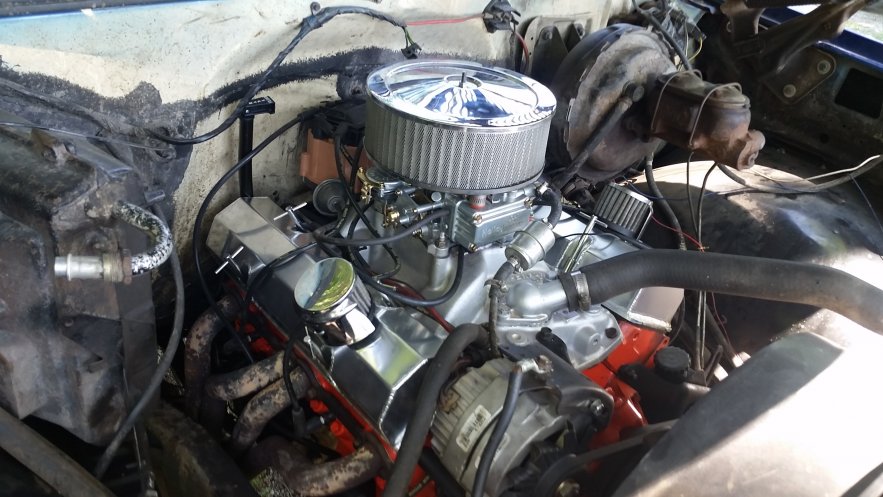

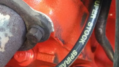

Here is the motor and the suspected leak lol

For what it's with I had those very same gaskets to begin with and they are terrible. Put some chalk our something around that gasket and see what it does
