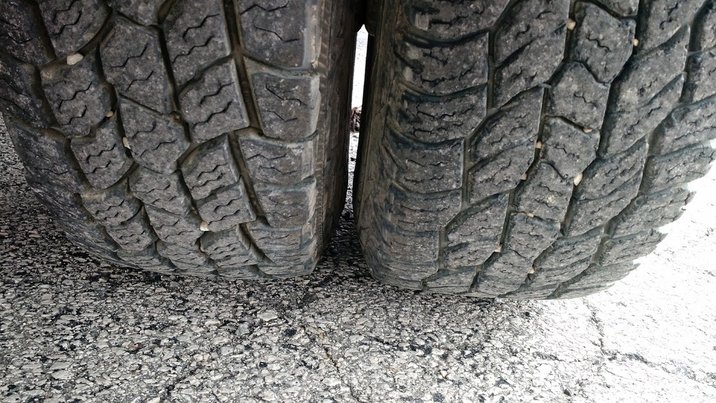

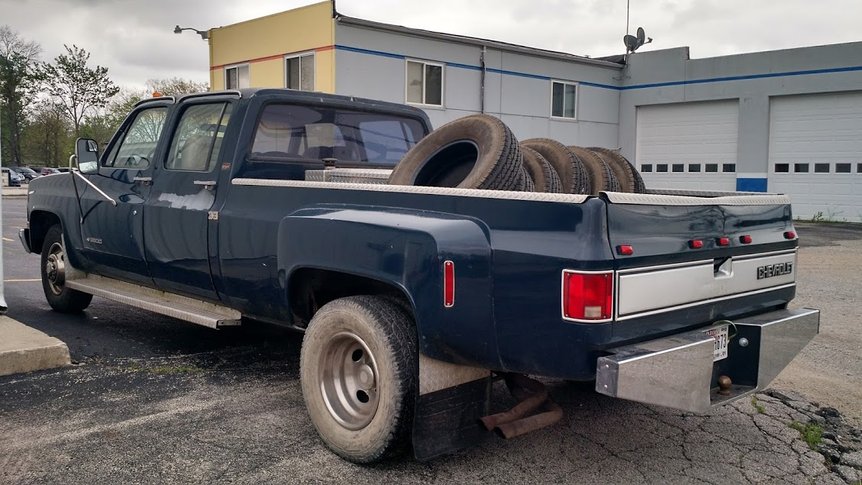

Got the gauges all working, and changed the fuel pump last weekend. Runs MUCH better now with the fuel pressure up to normal, but still has a mild stumble at low rpms under load that I'm chasing down. Blocked off the egr to see how it ran plugged up and it didn't change it. The stumble doesn't change weather the engine's warm or cold so I don't think it has anything to do with the CTS. Also changed out the cap and rotor yesterday with no changes. Don't know if I mentioned it or not, but the coil button was corroded as well, so I just ordered a new coil and will hopefully put it on soon to see if that fixes the stumble. Kind of running out of ideas tho if that doesn't fix it...:Insane:
Got new/used tires on it today too. The old ones were dry rotted REALLY bad... 245/75/16 fit like a glove in the rear!

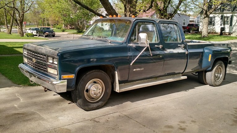

Just a follow up again... Got it fixed !!!
Turns out, the previous owner must have done something with the spark plug wires because cylinder #3 and 5 were switched!?! I replaced the wires a few weeks ago, but when I do them, I switch them one at a time so I don't have this happen... but I didn't even think to check if they were correctly hooked up. At least it was an easy fix, although it was driving me NUTS!!! Thanks for all the help guys.
