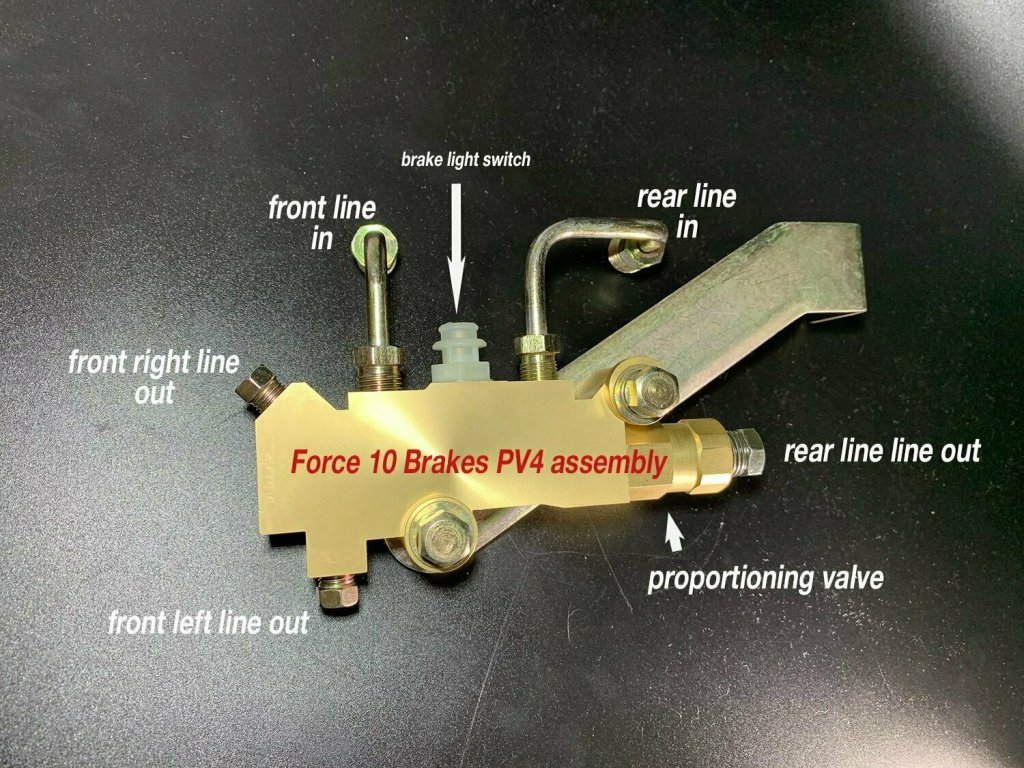

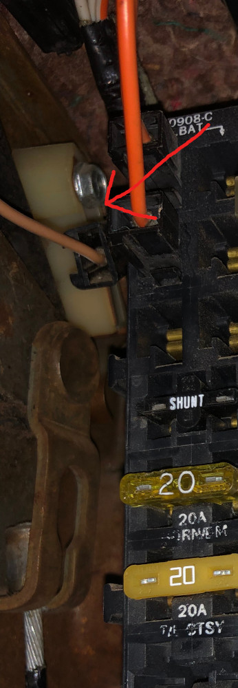

The parking light comes on when tan-33 wire (going to circuit board) is grounded. It can ground at one of two locations. It is grounded by the switch at the parking brake & brake proportioning valve (usually on frame under radiator) - Make sure the tan wire isn't grounding out at those locations or on it's way there.

Attachments show where the parking brake switch is & what the proportioning valve will basically look like.
