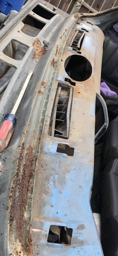

anyone have any idea how many spot welds there are to remove the entire metal dash panel ?
A lot. Mine had a spot weld every inch or so
When I got it out the I took the time to rust proof it.

Thanks. I got the glass out and was just noticing all the spots
