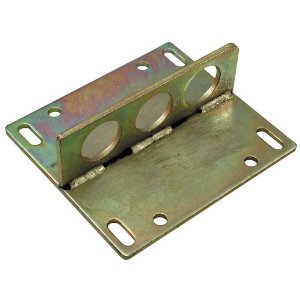

The easiest way to pull a motor is to use a plate sold in most parts stores that bolts to the intake in place of the carb.
47,132
9,331
yeah, that's it. You found it before I got my link and pic posted. Also a little cheaper and no shipping than Amazon. Same brand too. :waytogo:
For a motor only, those are OK, but I don't like using those to lift a motor trans combo. For one, just seems to be alot of weight for 4 smaller bolts in a smaller concentrated area, but the biggestd reason it, you are lifting the center and no way to tilt, where are a chain front to back of the engine, you can gain tilt by just moving your hook to a chain link closer to the front of the block.

I would be worried about using one of those with an aluminum intake too. I would just stick with the leveler that bolts to the heads.

When doing a motor and trans together, though, you'd be better off attached the chain to all four corners of the motor with a motor leveler to help with tilting as you pull them out especially if you still have the front clip on.

I would agree on worrying about the plate, my old man don't trust them either. Too easy to strip bolts in alum. esp when holding something heavy and trusting them. A load leveler is the only way to go. A chain works perfect for engine only, used it many times you can see in the pics that's what we used.
