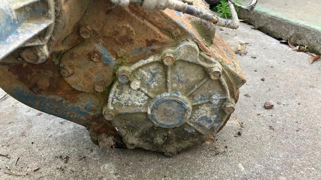

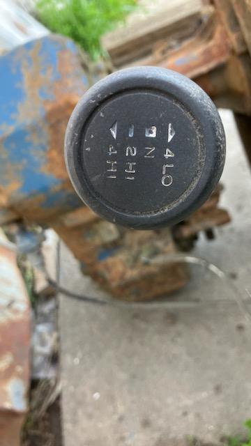

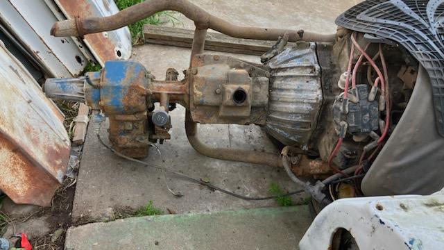

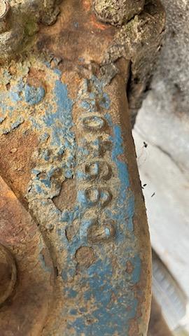

Looking at this guys transfer case. I'm not sure if it's a np205 though. Coming from an 80 k10 with manual trans

Also, that specific one with a rear slip yoke and being an non-syncro type was used in '80-'84, regular cab trucks (single piece rear drive shaft) and with manual locking hubs.
