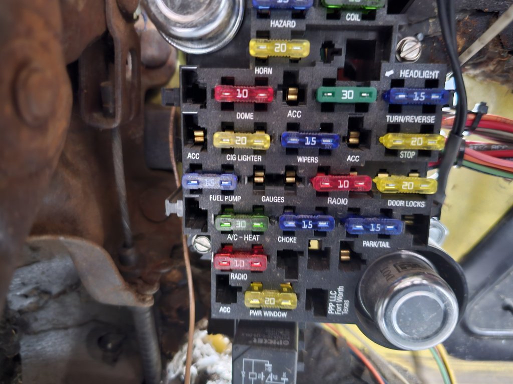

Very nice article, definitely clears up questions on how that works.
Since the headlights aren't running through a fuse, what's the purpose of the headlight fuse?

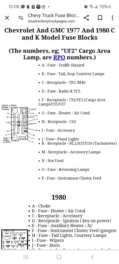

Post a picture. My 75 doesn't have a headlight fuse marking on the fuse box. The 77k pic I found on the internet does not list one either. I think you maybe looking at something wrong.

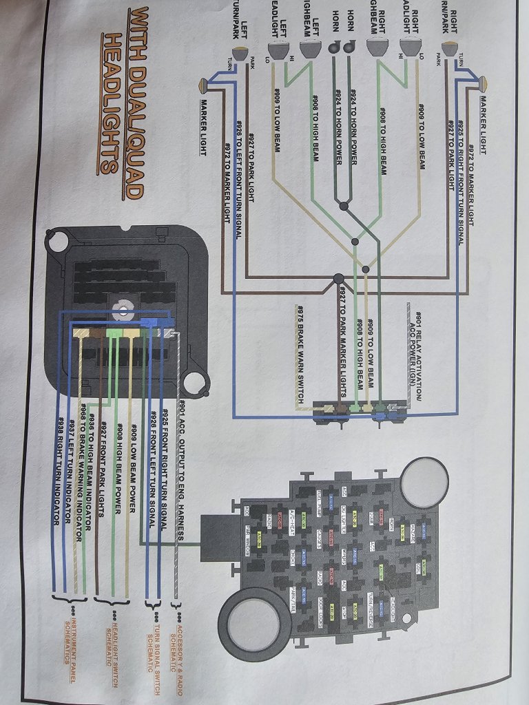

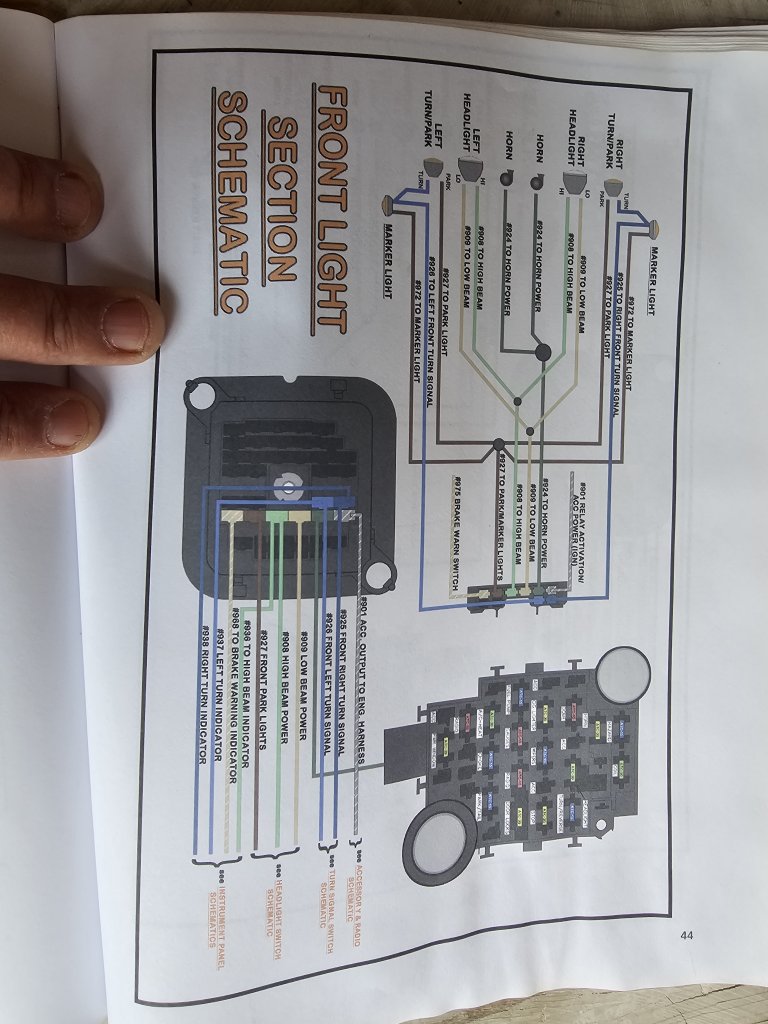

A few pics of the manual that came with the harness, as well as the fuse box mounted. The fuse labeled Headlights is the one that kept popping previously, before I moved the high beam indicator wire that was shorting
