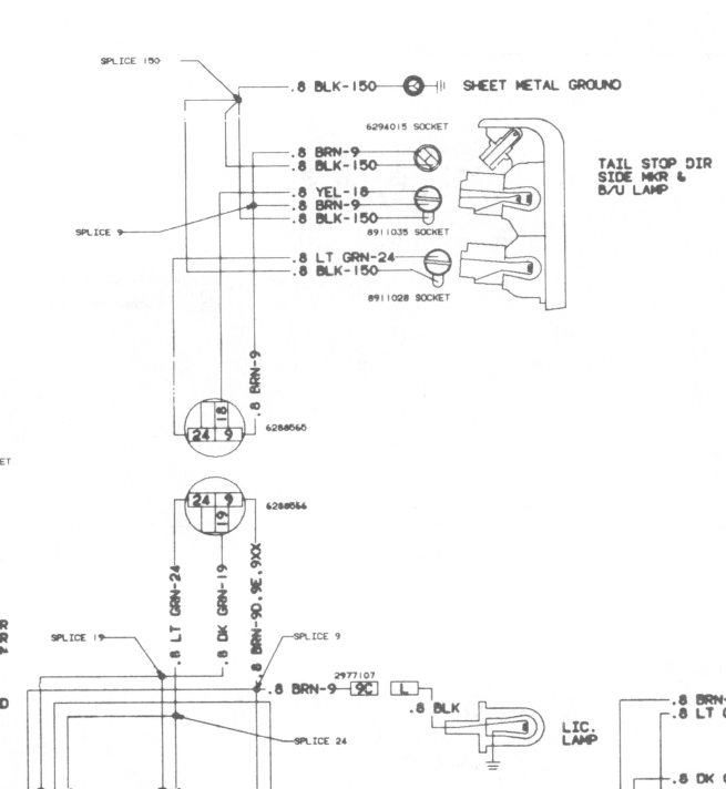

Good Morning everyone. Got a question about my right brake light, on my 84 C2500. I've replaced the socket/pigtail twice now, and the brake light keeps going out, then will start working again. When it works, it goes for quite awhile then all of a sudden it quits working. Taillight on the right never goes out. Just the brake light. No issues with the left side. Ground issue? I'm thinking of replacing the harness as I know it's kind of a mess from being a farm truck at one time. Who do you all recommend for one that isn't crazy expensive? Or should I just take mine out and make sure it's in good shape?
