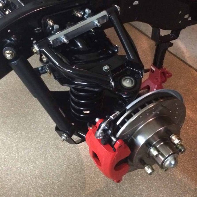

Check out CPP online,
http://www.classicperform.com
They have many options for brake upgrades and there prices are not that bad. Here is my front brakes from CPP, go check them out...
