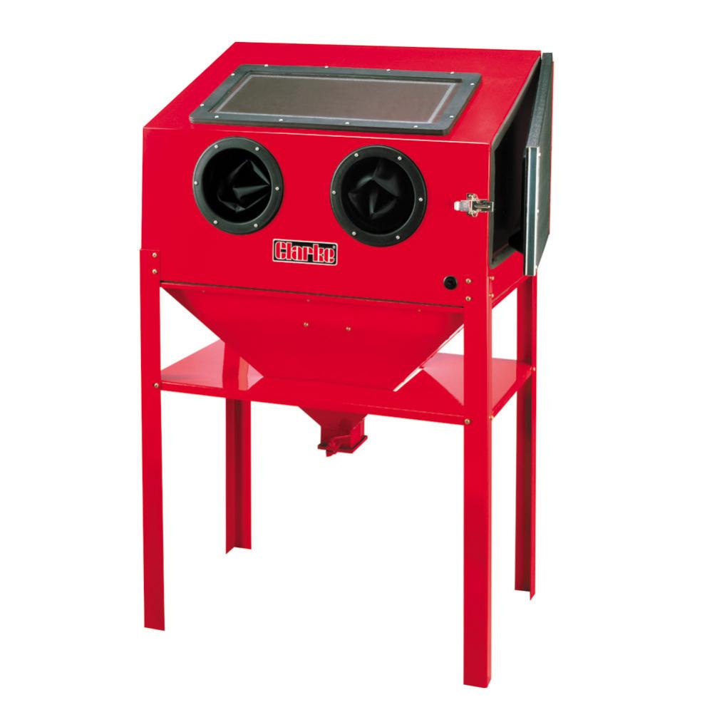

i used the blasting pot from eastwood to blast the under body of my vega and it worked great. i shoveled up the sand sifted it and reused it.
and i have a blasting cabinet i bought of ebay i use it alot
