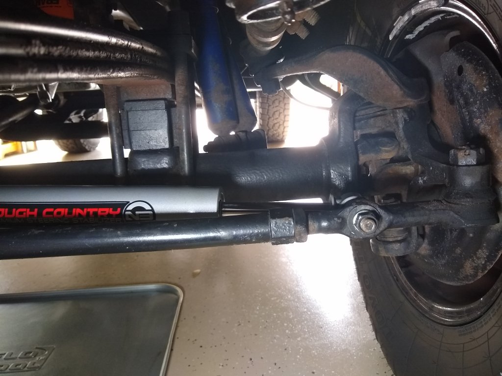

I bought the truck this way years ago. It hasn't killed me yet. I would like to get rid of the 3"of blocks in the front. Is it safe to say 3" lift leaf springs would provide the same lift so everything would still line up as it is now? Is Skyjacker or other better for a more comfortable ride?

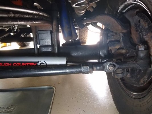

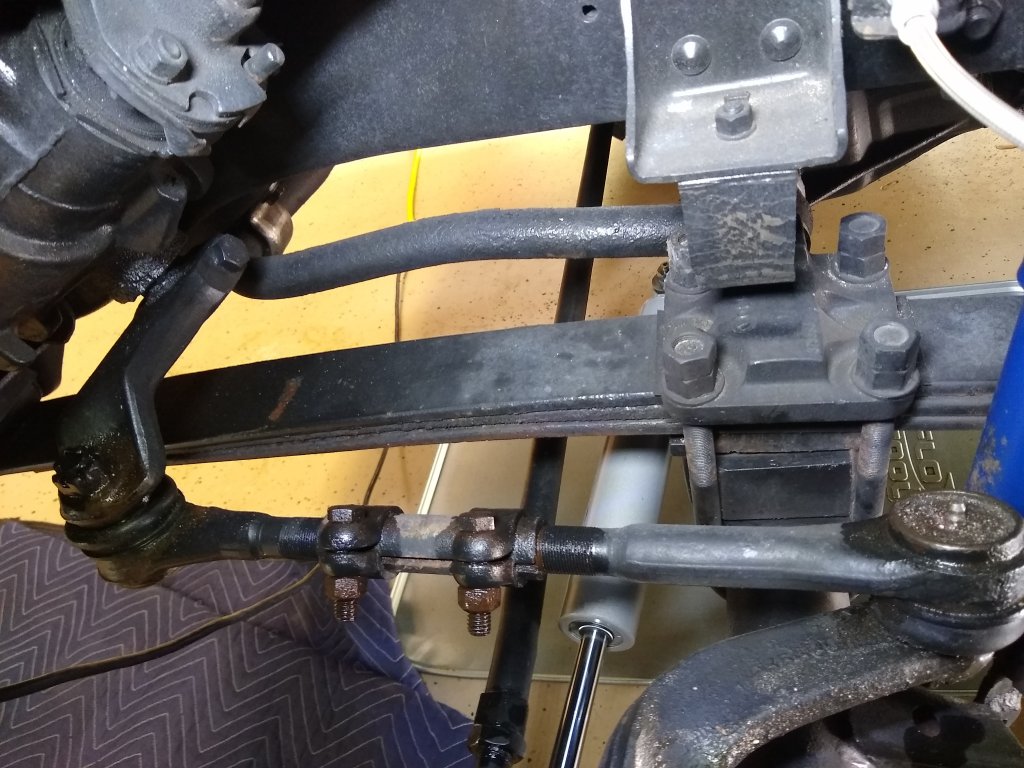

@Ron Sebastian can you take a pic of the truck so we can see about how much lift you actually have? I see three leaf springs, the original on a 1987 V10 was actually just two. That means you probably have a little more than just the block, although I agree with @Vbb199 those springs still have some negative arch so they are old and sagging.
I recently installed a set of Skyjacker 2.5 inch SoftRide springs on the front of my '87 V10. They were actually over 3 inches of lift because the spring stack is much thicker than the original 2 leaf setup. I can say that they ride a lot smoother than the OE springs and also much better than the add a leaf lift setup that was already on it. I cannot say how they compare to any other brand.
My truck has 2inch blocks in the rear but on the original rear springs. It's sitting on 33x12.50s.
I have a few pics that may help you:

The pic shows the front higher but it is really fairly level. I'm sure the rear springs are not stock either.

What I'm getting at is, I haven't seen anyone that sells lift kits with front lift blocks...... so I'm inclined to think, if the PO did lift blocks up front, it's a 99.9% chance they did lift blocks on the back also, meaning.... maybe you do have stock leafs out back.
How many individual leafs are there ?

I can't make out the part number from your pic. Skyjacker site only shows those springs for CJs.
If you decide to go with the SkyJacker your best bet is to call their Technical Support line. They will tell you exactly what part #s you need. You will have trouble finding what you need on their website.
You will want their U-Bolt kit, and FYI you will need their bushing kit also. The SkyJacker springs use a different bushing size than the OE springs, you have to use their bushings.
I used SkyJacker because they were based relatively close to my home and they seemed to check all my boxes. I am sure there are other companies that might have done just as well. Tuff Country offers an EZ-Ride spring setup that is supposed to ride really well. Everything I read about Rough Country indicated that they were appropriately named, I didn't see any soft-ride/easy ride options from them.
Edit: When I get home I will see if I have the paperwork for the part numbers.
