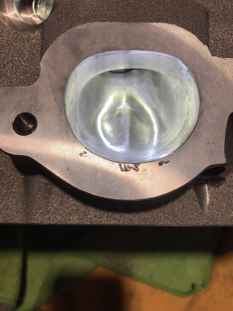

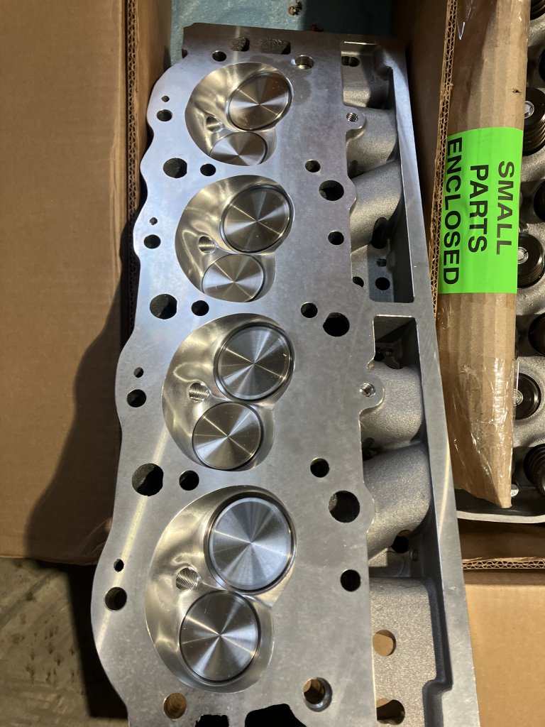

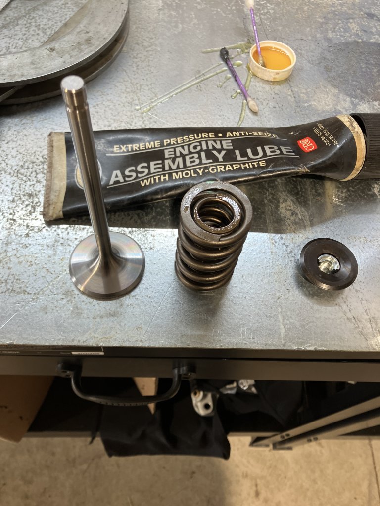

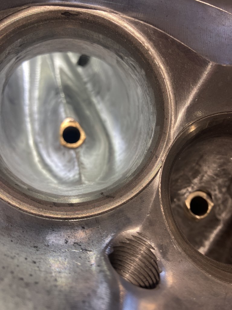

Its Friday, and I had a good day in the shop. First two pics of the finisher ports. Cleaned the heads, and assembled. I blow the guides out with carb cleaner, air, then lube, assembly lube, and Lucas, as it is so sticky and stays on the stem. It is nice having the valves in, but cannot install the pushrod guides, rocker arms, until I get my cam......but it came late this afternoon.

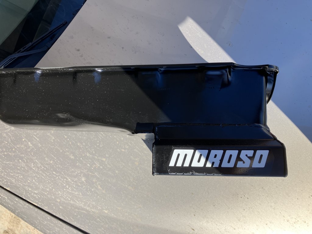

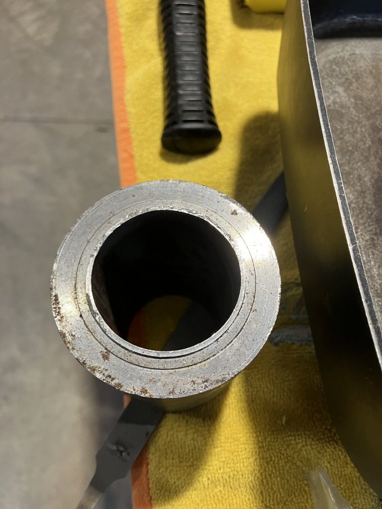

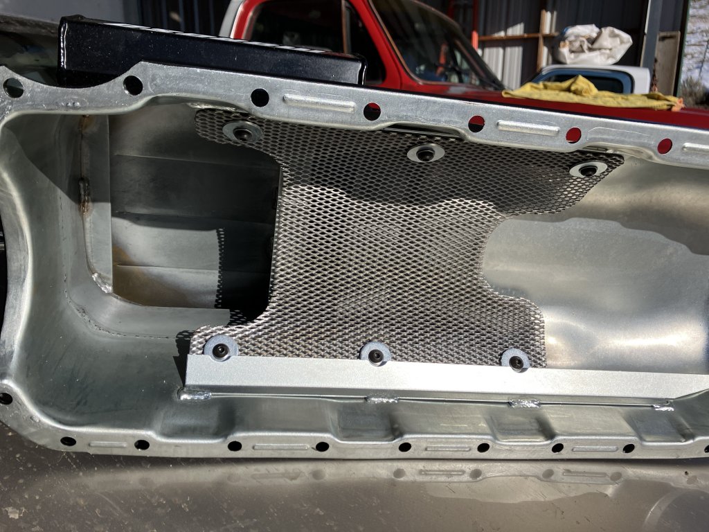

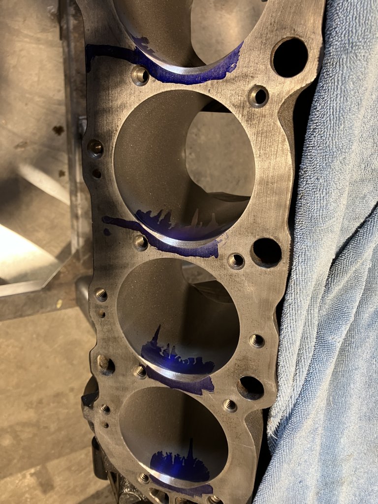

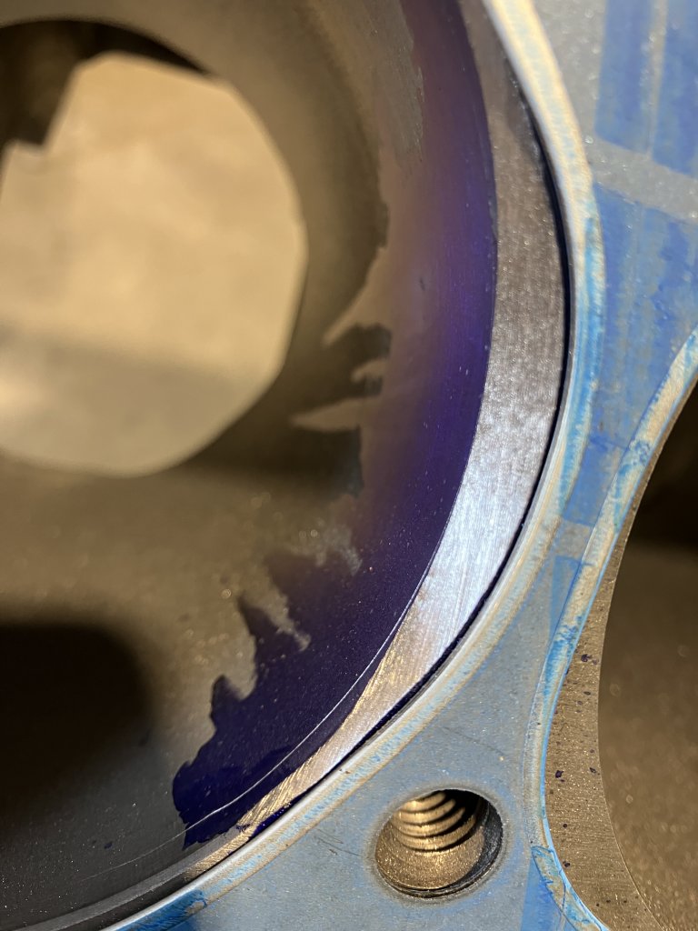

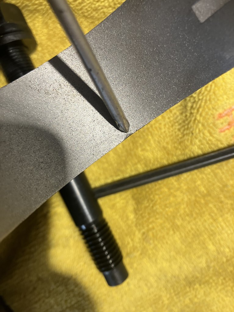

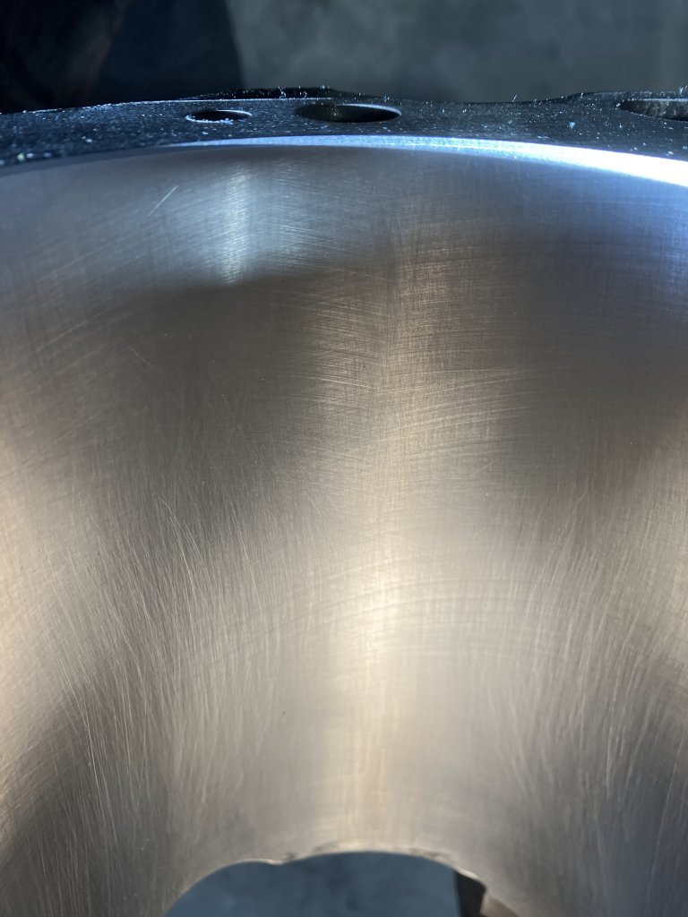

I also notched the block to help with intake shrouding, 1st two pics. For those that want to know, stay .06 off the top of the ring, and use your head gasket as a templet and scribe a line. I had hard stones on a die grinder, and finished with the finest cone I had, but pleased. Why? worth about 10 ft. lbs. of torque, and 13 hp at 6000 rpm. We'll see how it works. My block mods are now complete. Pan came today. This pan has been tested, and is worth hp, and a nice piece. The power is made through oil control, which I have taken pains to address if you have been following along. Test say this is worth 9 ft. lbs. tq, and 11 hp. See, just made 24 hp.

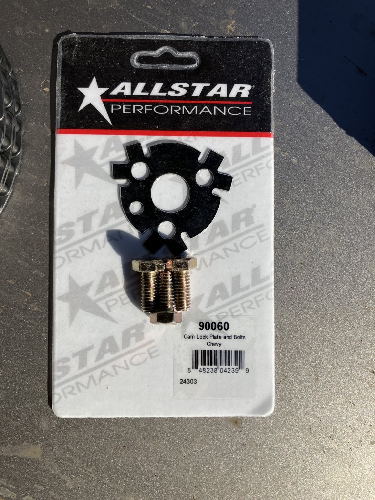

I like a positive retention of the cam bolts, and ARP bolts for the head. Fit perfect.

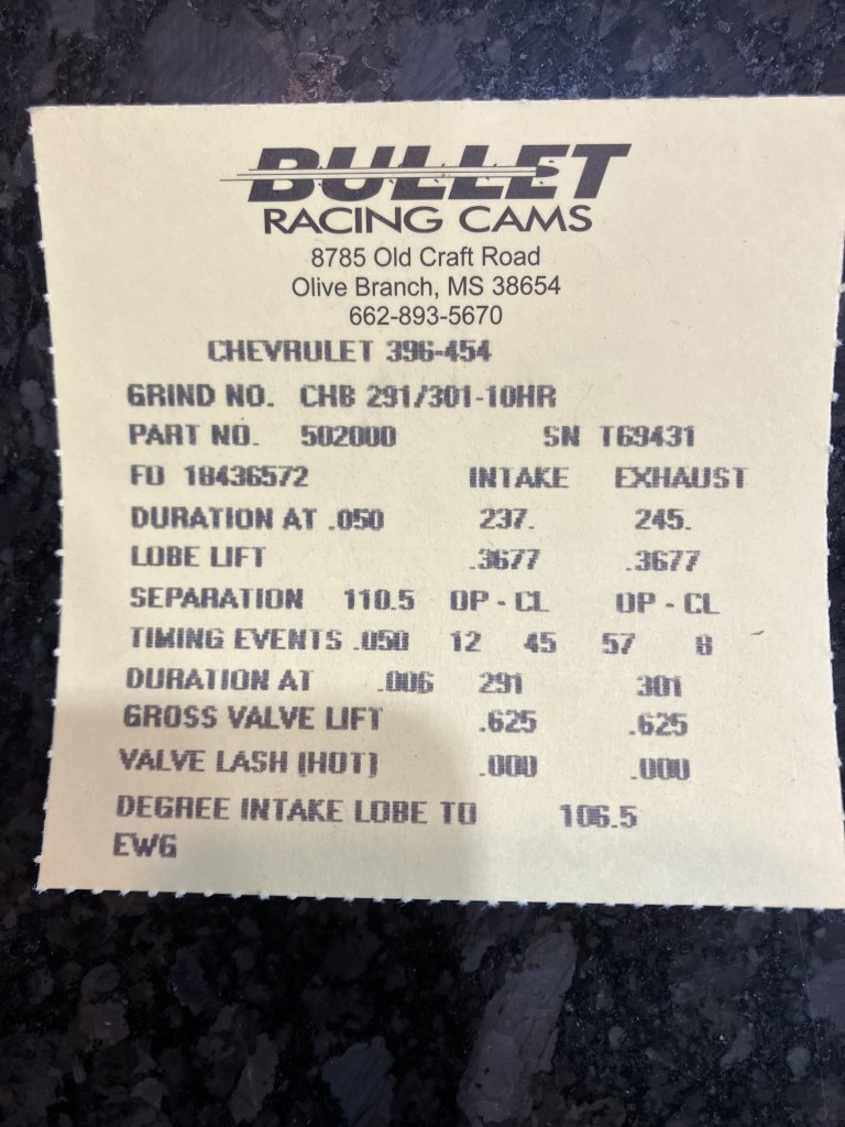

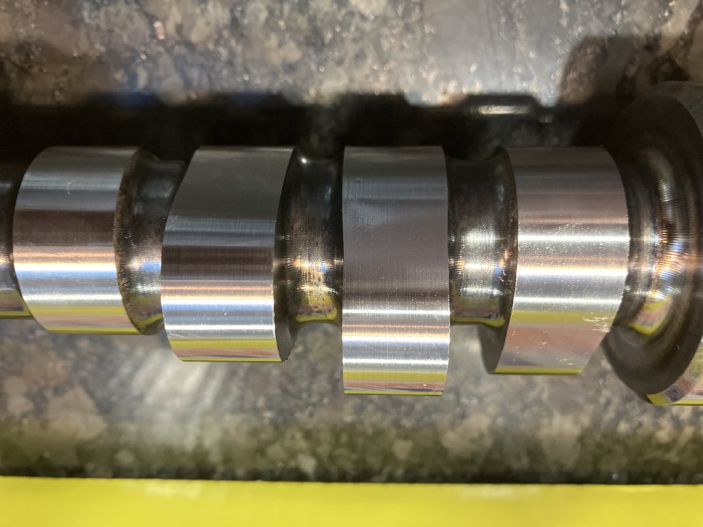

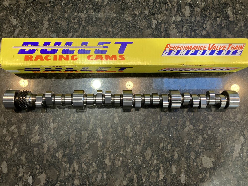

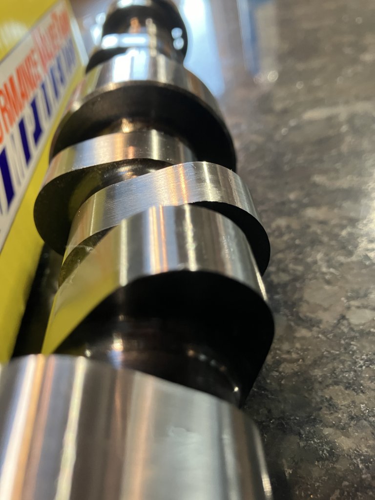

The engine brain cam in today, a few pics. In retrospect, I wish I had gone solid roller, less trouble with solids, and much higher lift. Disappointingly the Johnson lifters did not come like they were supposed to today. Cam is beautiful and should work good with this combo. I had to use more duration because the heads are a bit small for this engine. However after the porting, and block mods, hoping for an extra 20cf. If I can pull strong to 6500 rpm's then I know the heads work. Probably more like 6200 rpm's. I will go over the cam tomorrow with a stone if there is anything that needs deburred, but I doubt it.

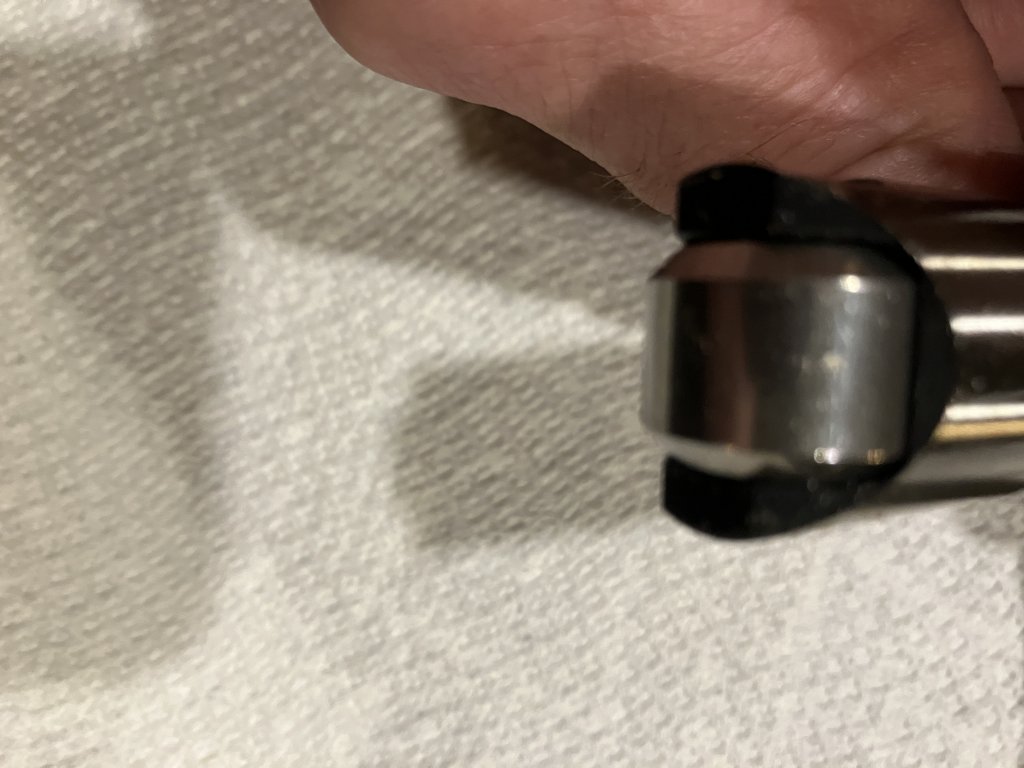

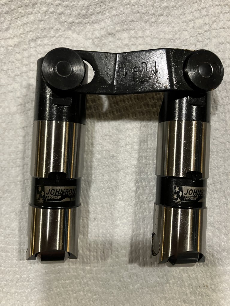

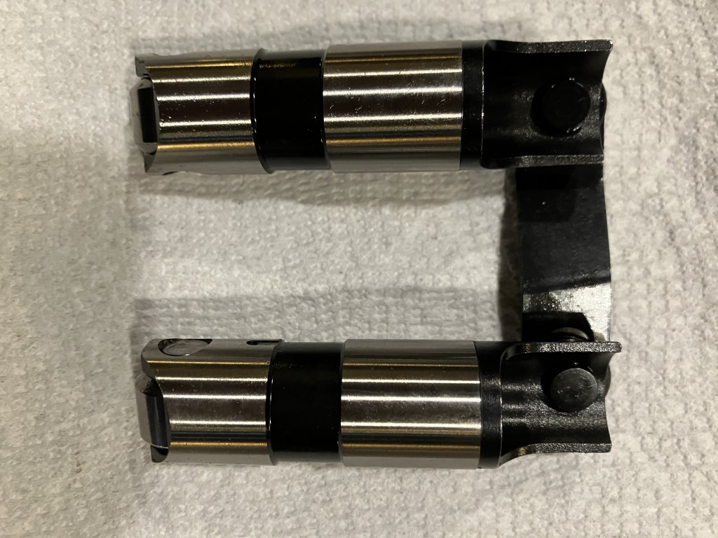

Busy, but not on this. However got the lifters in today, and told my wife this was like diamonds and ruby's to me. Cant wait to get some of this stuff together, and much of the tedious prep is done. Hope to install the crank, cam, and timing chain to see how everything feels. Hopefully it takes very little effort to turn with light oil. If it feels good, remove oil and replace with assembly lube.

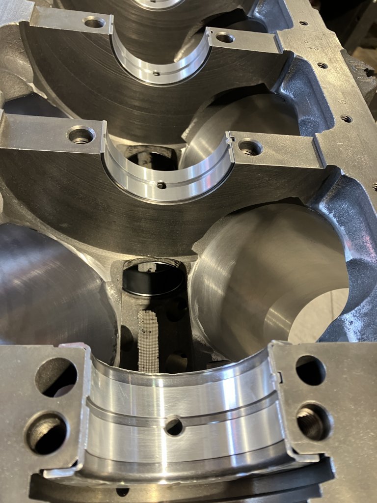

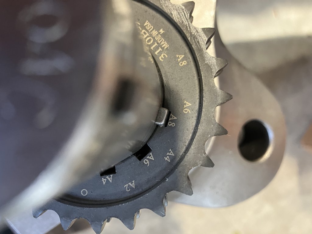

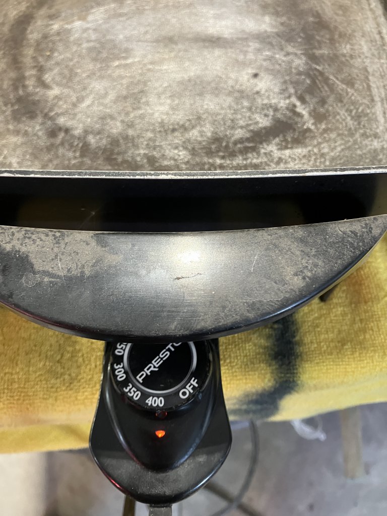

Some done today. Back cam bearing was too tight, unfortunately I had installed the crank. Fortunately the crank spun so nice , but I pulled it and was able to hone/ scrape in the back bearing. Also took some out of the second to back, as it was too snug. Anyway cam is now good. I did install the chain on the cam. Earlier I used an old electric frying pan to heat up the cam sprocket to help with installation. It is cold out, so left crank out, then had a piece of tubing that fit over the crank to drive on the crank sprocket. Went on easy 8 degrees advance on the crank.

Tomorrow is town day, and visit Mom, so probably not any shop time. The machine shop should have checked this, BUTTT, I am the one doing the assembly... Soo if you are doing this, check the cam in the bearing before installing the freeze plug, as that gives you easy access to the back bearing shell. I used a brake wheel cylinder home on a custom extension that attached to the hone. The extension was 16 inches long and was attached to my electric drill. Allowed me to drive the hone from the front of the motor, Anyway it worked and am satisfied. I also did some hand scraping as well. All in all a snitch tight, but acceptable. Spins nice. Pic, always check for stuff like this, Little nick, I just used a round file to file that off.

Had the same thing when I did the dingleball rebuild on the slant six in my Dart, put new cam bearings and and go to drop the cam in (literally, had the block stood up) and a had do do some scraping and honing. Thankfully without the crank in place there is plenty of access.

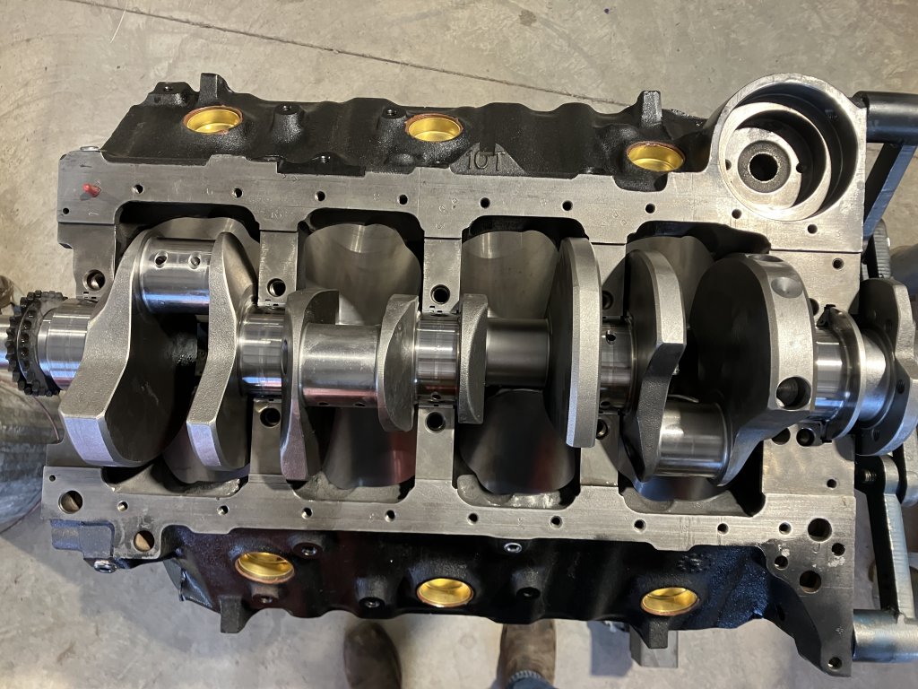

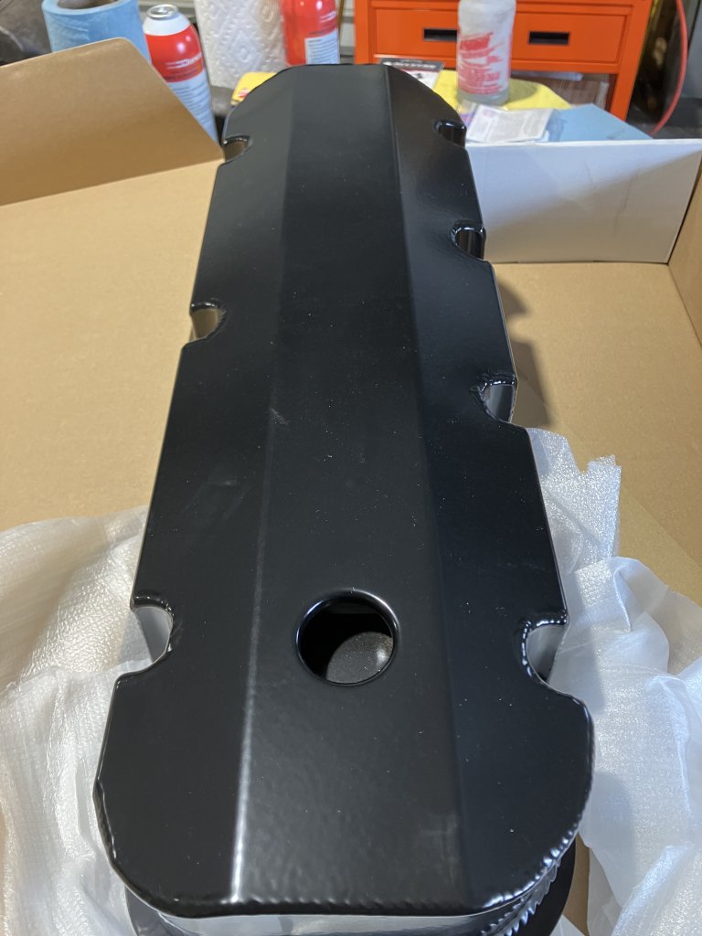

It's Thursday and had a little shop time. Block is clean now, and was able to install the crank and get it all torqued down. Got the valve covers back from the powder coater, and I like them. Was a beautiful day, pic off my front porch.

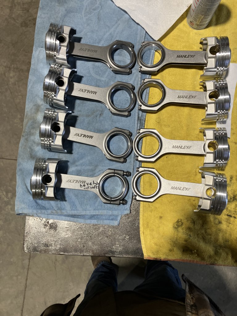

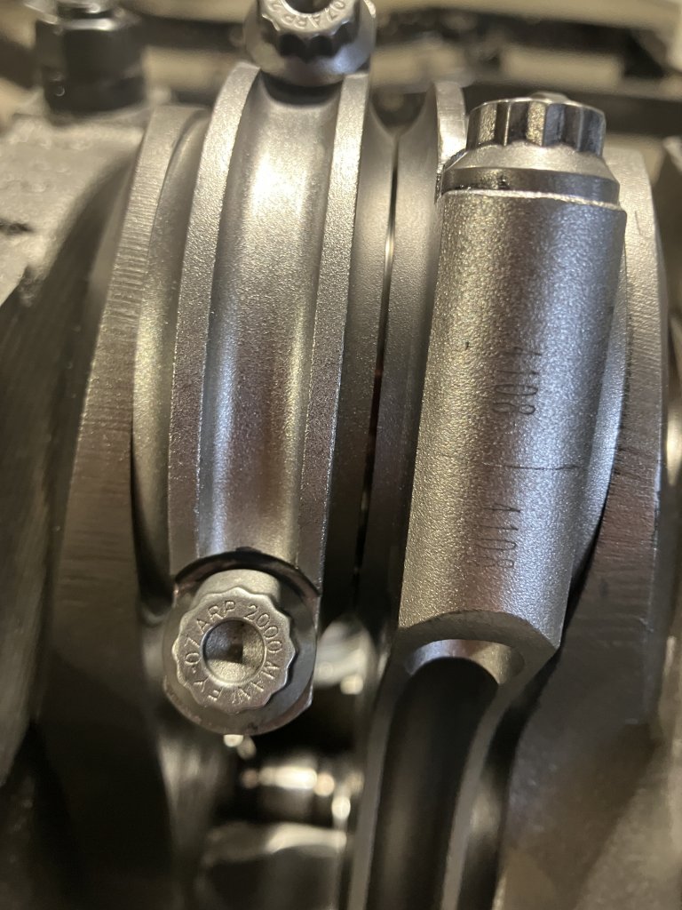

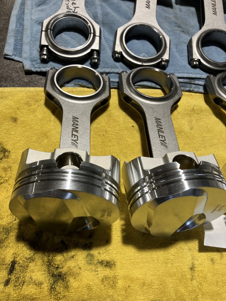

Having a heck of a time with crank end play, but think I have it, was no play, so removed 5th main (where the end play is determined) and sanded them on a piece of thick tempered glass, because it is flat, and cheap. Here are the piston and rod set up. Hate the double spirolocks, a pita to install, but getting better at it. The Wiseco pistons have a compression height of 1.28, .010 higher then standard. This is great, as I do not have to deck the block to get the right compression, and still have good quench. Rods have .028 side to side gap, just fine. Main bearing clearance was .002 on 1-4. and .0025 on #5. Rod clearance is consistent @ .0015. Minimum clearances allows me to run a lighter weight oil, less volume, both increase power, and better oil control. The rods @ .0015 will flow about 1 gal a minute, whereas .0025 will run about 3 gallons a minute. The three big oil users are Main bearings, Rod bearings, and Lifter. Keeping tight clearances helps a huge amt., with oil control, windage, and crank oil entrainment.

There is not to much to know about piston and rod assembly except the big chamfer on the one side of the rod will go to the outside of the crank. The reason is that these new cranks have a radius and the chamfer is for clearance. Other then that, just have to have the piston dome towards the outside of the block. My goal is to load the pistons on the rods, install double spirolocks, oil ring spacer, then all the rings. Maybe some assembly on motor as well but I like to go slow and check everything. Rods have ARP 2000 bolts, and get torqued to 95 foot lbs. I measure each bolt with a bolt stretch gage, write that down, then measure after they are to torque and check bolt stretch, supposed to be .006. I will show that down the road.
