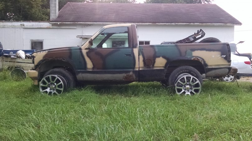

I've got factory 04 17s on my 94 that look good on a lowered trucks.
GreaseDog
Aug 8, 2010
1,189
36
Elkhart, IN
Jeremy
1977 K20
1980 K2500
Looks like you need the passenger side axle shaft for a Silverado SS, and a NV149 transfer case to make it happen.
I'm going a couple steps further probably, and upgrading to 99+ spindles, which will allow for the newer truck's bigger brakes (14" rotor). I've got the wheels to accommodate that, just need to figure out how to make it handle now.
Btw, this is my parts truck, I'll be using it's chassis, but none of the body.
