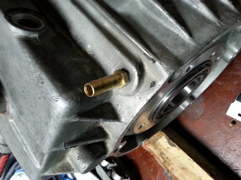

Decided to just tap the vent hole and puts 1/8" npt fitting in. Got most of the case assembled and while there is barely enough clearance for the hose, I don't like it. Need to find a 90 elbow that will fit.
Still need to put pump housing on and tail housing. Sonnax retainer shipped today and front oil seal should be here tomorrow.
