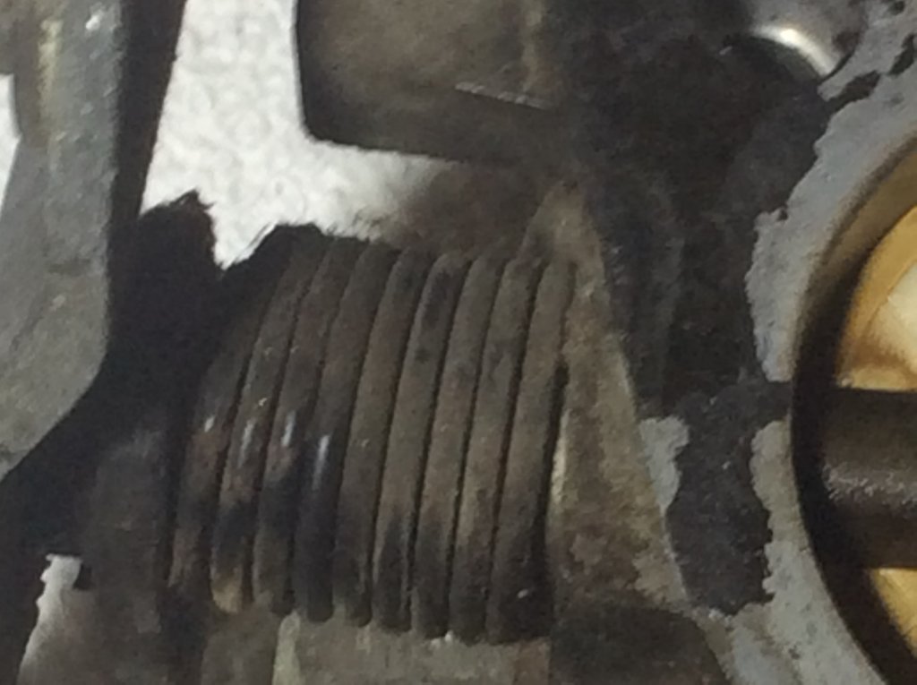

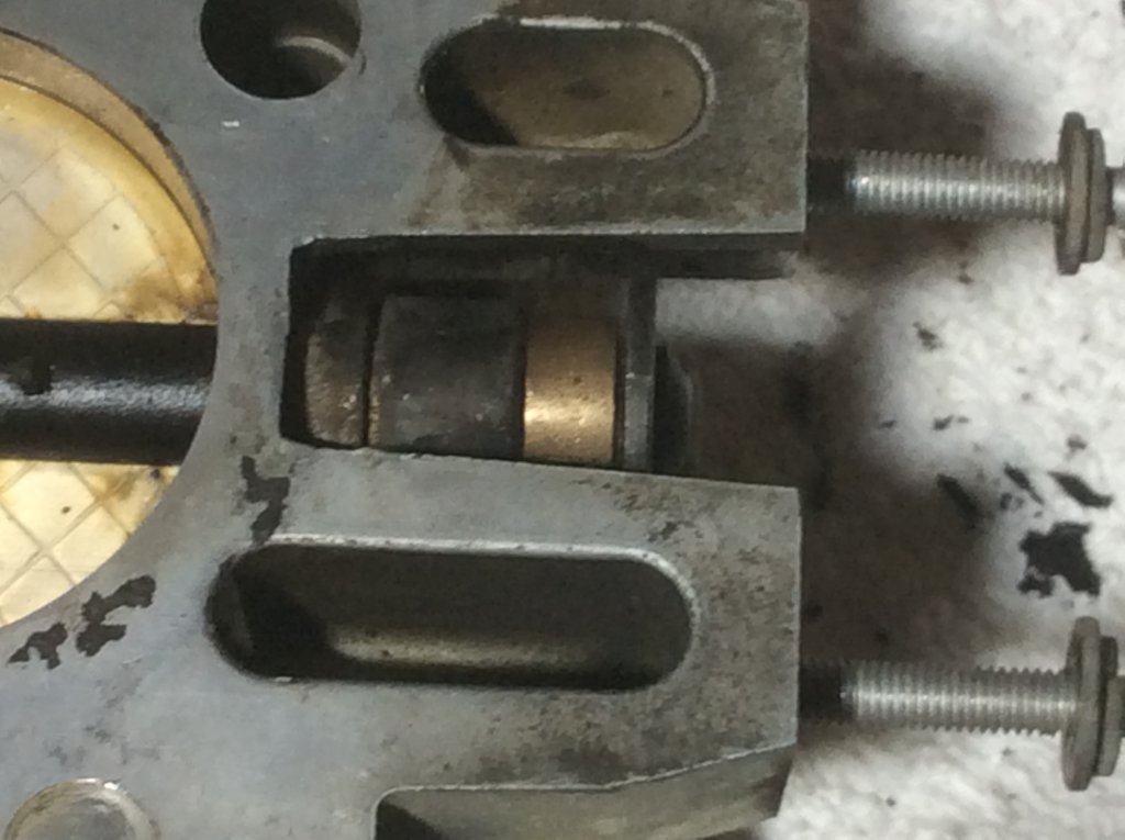

Ok a quick update!!! I took the spring off the opposite side from the cable linkage. One screw and popped the spring out, big difference in the throttle linkage tension!! I made a spacer out of a brass door bushing to take up the space of the spring,not sure if that was necessary but its in and seems to work fine!! I will add a couple pictures later on. just waiting on the rebuild gaskets to arrive and see how it works the truck

I just posted what I tried ,throttle tension is much much better!!

the spring is on the linkage side of the body and the brass spacer is where the other spring used to be!!
