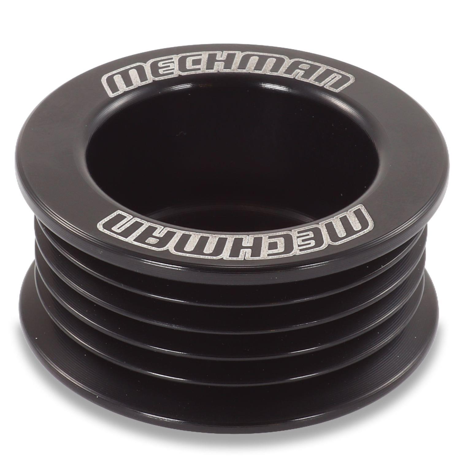

I think this is the smaller pulley that I got.
My idle voltage with the high beams on is 14.2v. I've also increased my wire sizes going to my starter, alternator, ground and bulkhead buss bar.

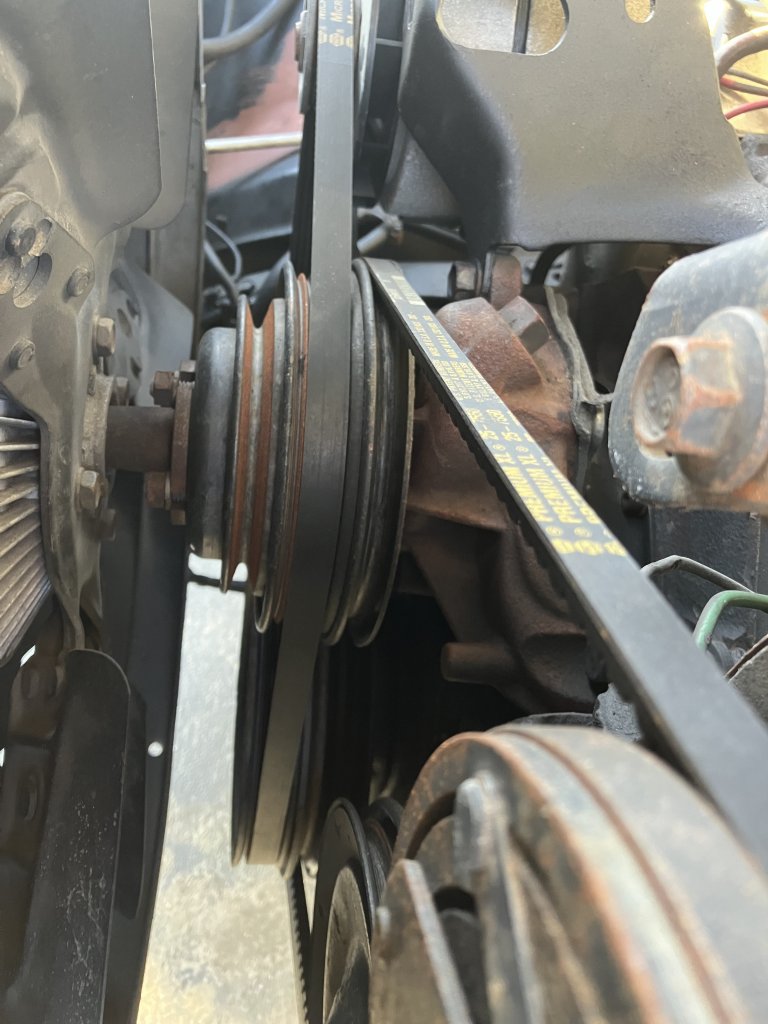

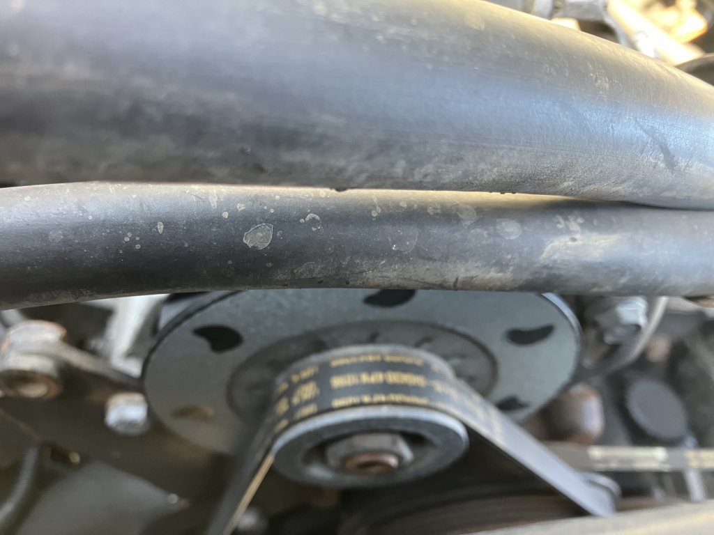

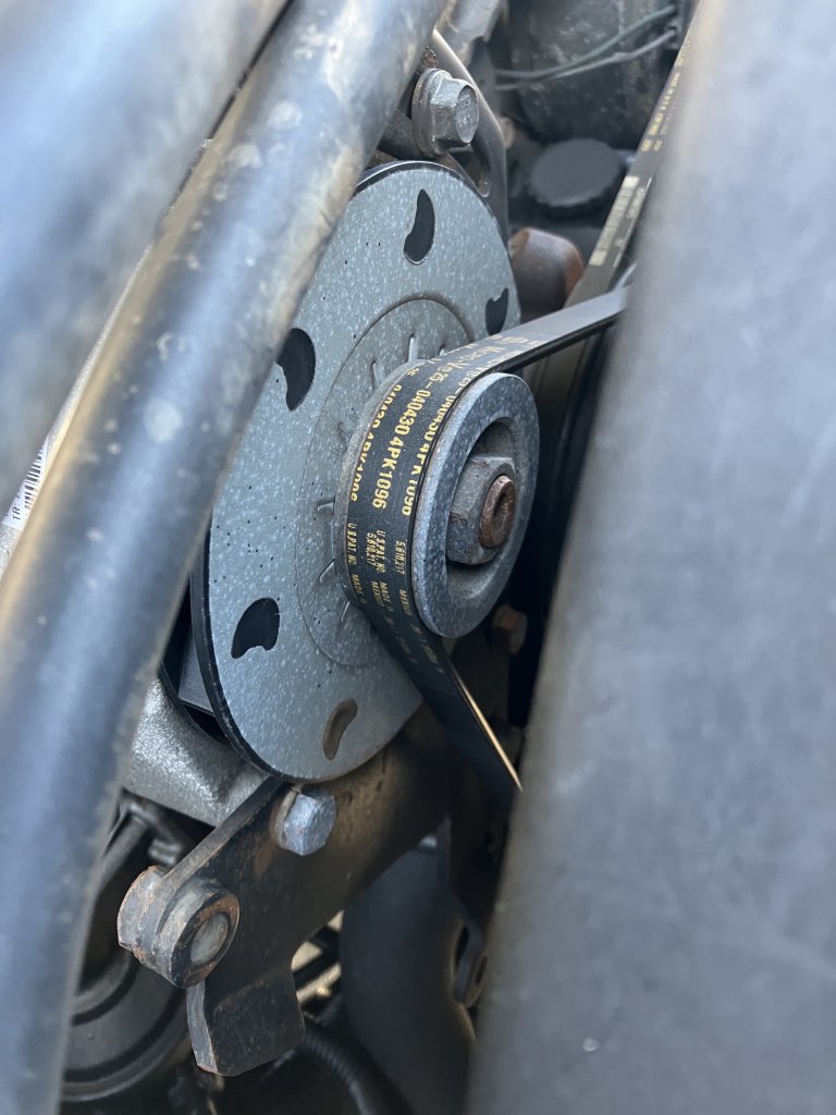

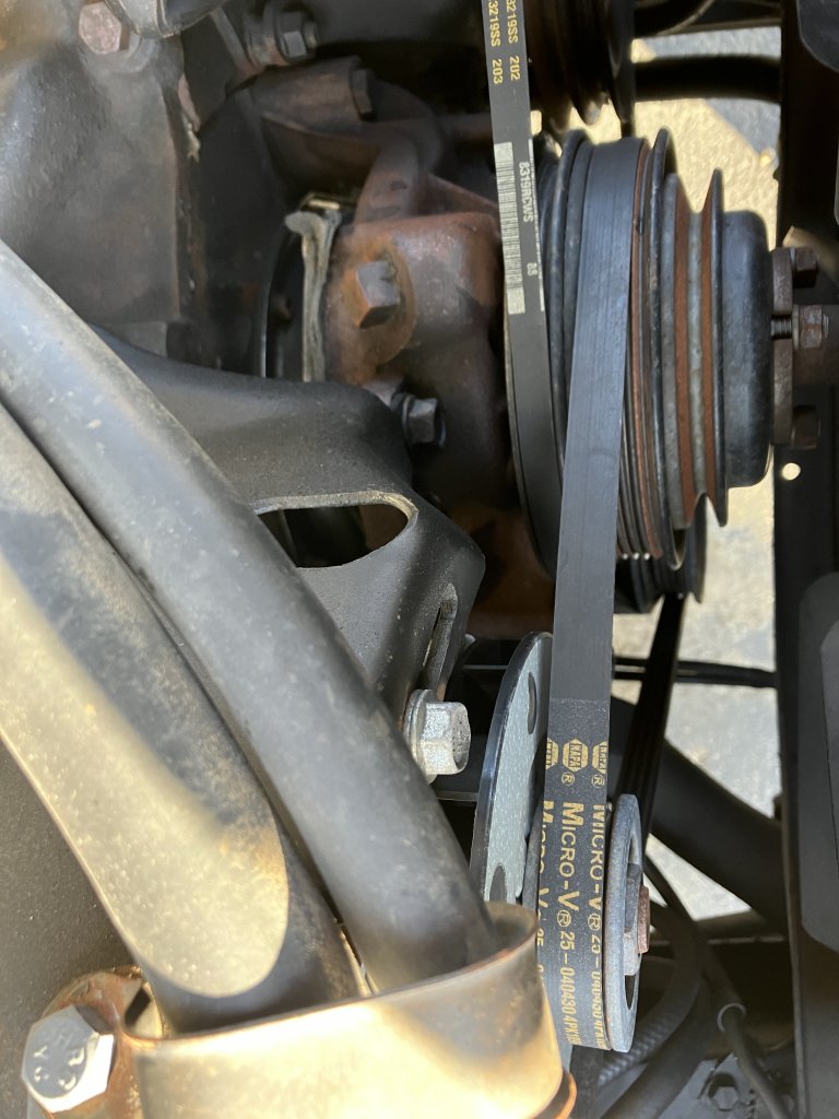

So unfortunaterly, slighhtly, you have a rarer belt setup. Could you send a picture of your belt drive, I want to see if its the narrow looking serpentine like belt or if its the normal width kind.

Sorry been busy last few days. I really feel like the alternator has some sort of dead spot. Gonna have it tested. If I need a new one probably go with 94 amp. Also I need to measure diameter of pulley.
