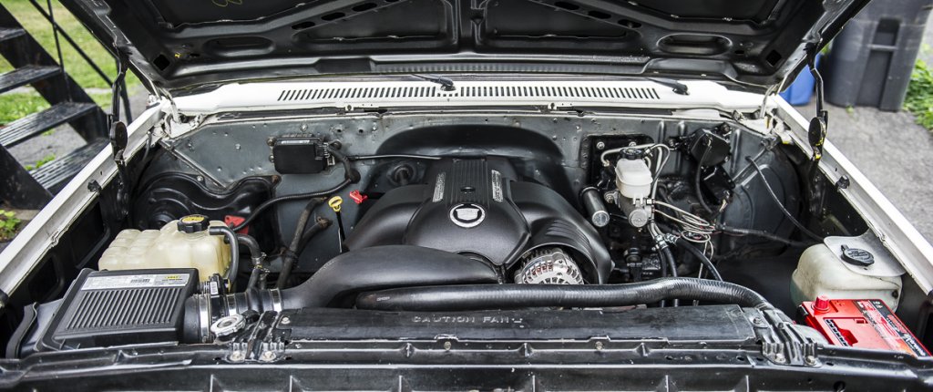

Got the engine back from the Machine Shop. I'm a little under the weather right now but as soon as I'm better I'm going to start gapping the rings

I took over some dudes desk and worked on the truck today at work.
I made a bench harness and turned off the vatsnkats. I got the obd pro VT. If you get that one it will run you 86 bucks and change and then there will be another charge for two bucks and change because the company is based out of the country or some weirdness. It comes to the house in a few days though.
I followed this video I also turned on both fans at 175 and 180. That app is in celsiou so ya gotta Google convert it to American temperature.
Hopefully it will start and run enough to get it tuned up right.

I made my own engine mounts so I was able to use the stock drive shaft I just had to get a conversion joint. Here is the part number to go from the 2005 2500 to the 1986 C 3500

I was also able to fit the stock AC compressor. One thing I'm having trouble figuring out is what suction and discharge hoses I need. I called some places around here to see if anybody can make me some but they don't think they can. Does anybody have any info on what I need to do? Or where to get the proper hoses ?
