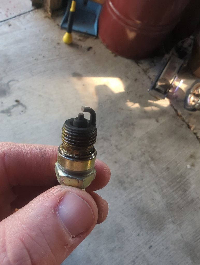

It started doing it before I changed the plug wires. Just pulled the plugs and they are a little bit wet and pretty black.

Pic of the cam card and a plug if it helps

Well I changed the plugs and wires engine sounds better but still won't idle without stumbling and stalling. I guess I will rebuild the carb and clean it up. I'm not very good with carbs lol wish me luck....any tips appreciated.

You could have a dirty or bad needle & seat, causing the float to be too high & flooding the engine. You're probably washing cylinders if it's rich, better get that float set properly!
