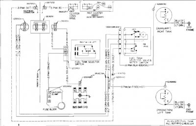

why are you trying to do it this way. Just leave the selector valve on, leave the bad tank on, leave the ground wire on the bad tank, leave the sending wire hooked up from top of bad tank to selector valve, then switch the selector valve to the good tank and leave it. the selector valve is mechanical (fuel supply) and electrical (fuel gauge) so it will read the tank you want.
you are making it more complicated than it has to be. this way you can just get a new tank and sending unit when you get the dough and then you will have a working dual tank setup.
here is the wiring diagram if you really want to tap into it.

a blown fuse indicates too much current. it is coming from your splice into the hot wire since you didn't say it was happening before you did that
looking at the dual tank diagram, you see that the selector valve switches between tanks mechanically and electrically. when it is selected to the tank, it completes the circuit through the ground on the top of the tank that runs to the frame.
if you really want to eliminate the dual setup, you need to find the pink wire running to the selector valve and solder it to the pink w/black wire(passenger tank). this would essentially be just like a one tank truck wiring setup.
where did you splice in anyway?
