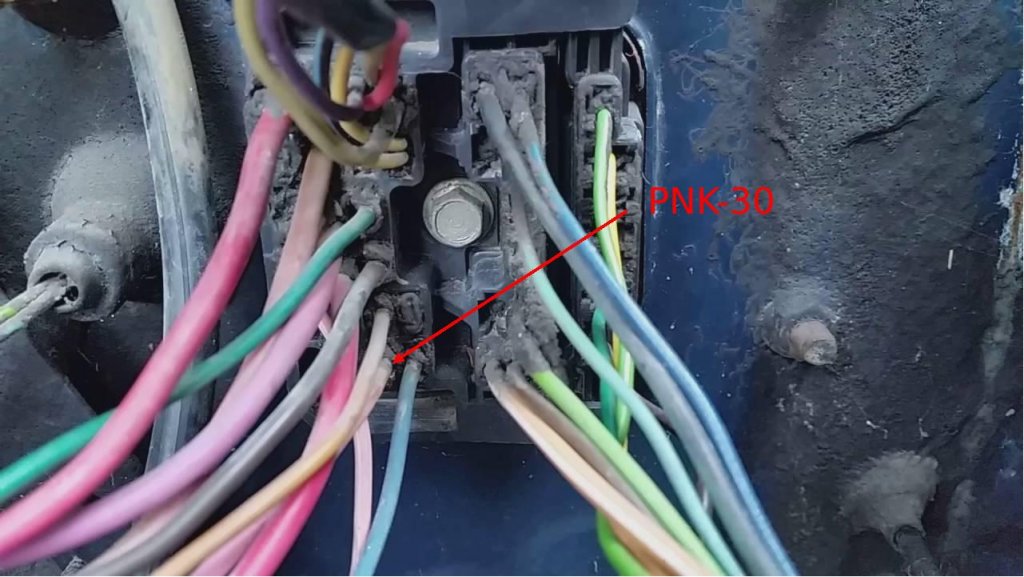

How do I bypass the old wiring from the second tank, and wire from the single tank sending unit to the gauge?
If PNK-30 wire is there, just connect it to tank instead of PNK/WHT-930. There might even be the correct connector on PNK-30 (notice on diagram above-the little circle on the wire)
attachment shows location of PNK-30 on bulkhead- you could check to see if yours is there if you are not sure

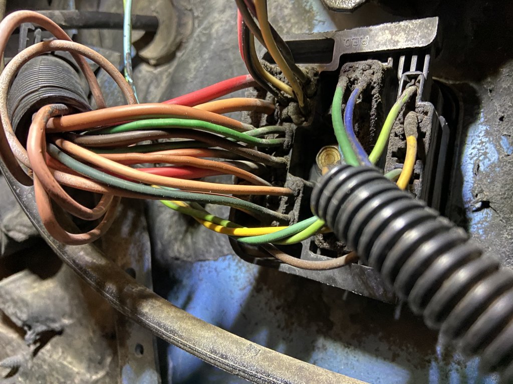

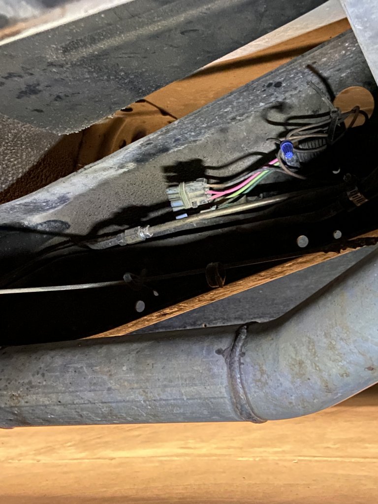

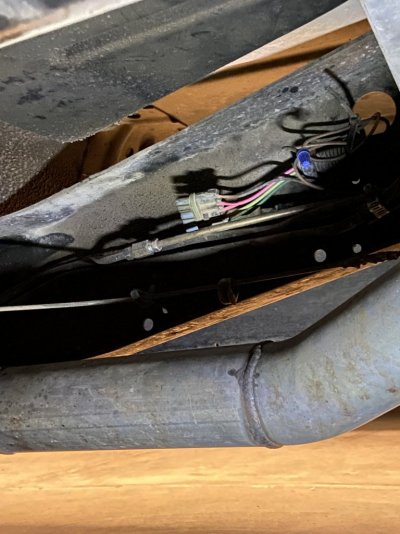

Here is some pics maybe give some idea. in picture one that connector that goes to nothing is the pink / wht wire they had connected to sending unit.

In theory- follow the pink wire (pnk-30) from 6 point connector- you should come across the same type of connector that is on the pnk/blk wire (the one you show in the attachment) - unplug it from the pnk wire running to 6 point connector and plug it into sender. - I believe it should reach the tank (hopefully)
Jtobe81
Sep 29, 2024
12
las vegas
Justin
1981 Chevrolet
c-10
Ok I found the connector you were talking about, disconnected it, was too short so i had to extend it. plugged it into the tank. good sign its not past full to the 3 oclock anymore. cant remember on these trucks, the tank is about 1/2 full maybe little more. when i turn key on it goes to about 1/2 then when shut off climbs back to full.
Thx for your help! making progress
