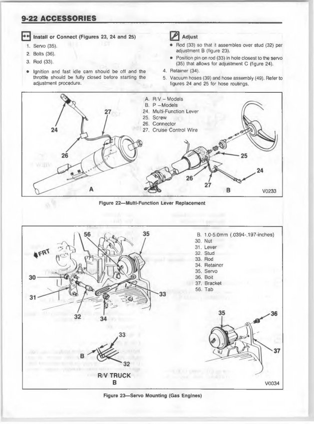

recently installed an 8.1L/4L80E into my 84 dually. Am looking into getting the cruise to work. Using a mechanical TB. Have a complete harness from an 90 suburban. Looking for ideas on what would be needed to hook it up do the TB. Steering column is from a 91. Thanks for any info

Sorry for not getting back sooner. Engine/trans control harness is from Howell EFI. Chassis harness is from Painless and is the replacement harness for these trucks. Biggest problem I see is hooking the cruise linkage up to the throttle body.

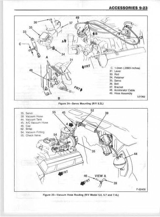

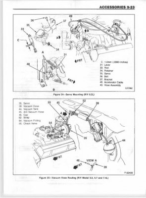

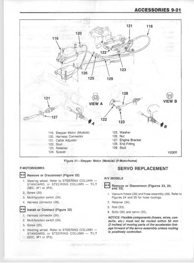

Couldn't find a picture of how the servo connects to the TB on an 8.1. But here are some images of the setup on smaller engines:

Thank for the pics, they help. Link wants me to pay. Not going to do that but thanks for the try
