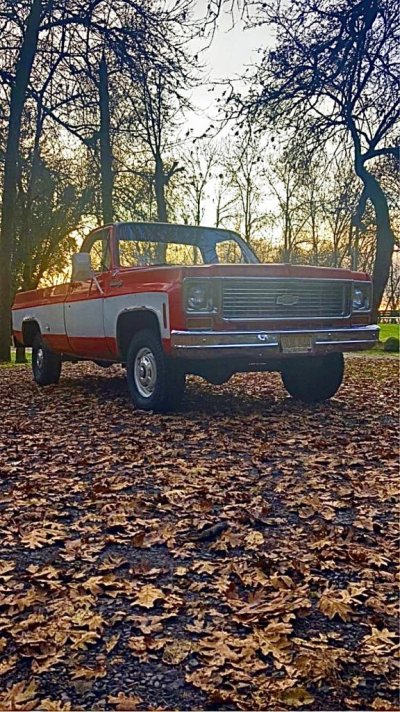

I got a 1974 k10 with a 203 transfer case, turbo 350 and a 355 sbc. The rear gear is 3.73 and at around 55 mph cruising the rpm’s are up to 3,500. That seems a bit high to me, does anyone know what I should do to the truck to get lower rpm’s at 55? I’m also getting 8mpg.
