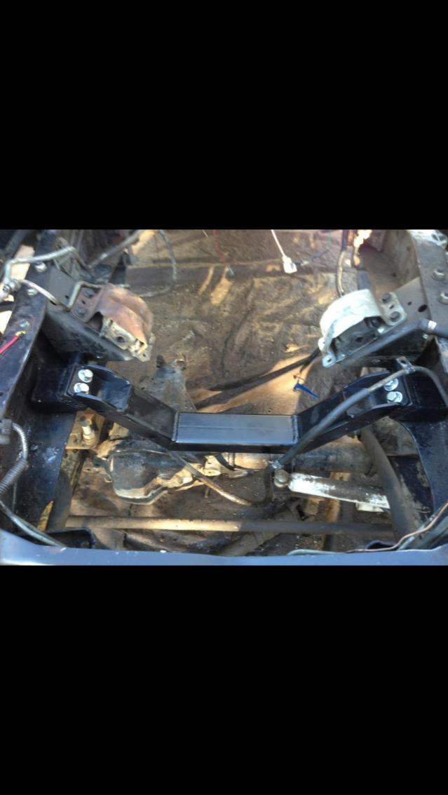

I know I can't wait either! This is the kit I will be using http://www.tndieselpower.com/site/products-page/conversion-parts/mount-member-package/ Is the kit you used to? If it is does it come with every single nut and but you need to drop the engine in? I might still box up the frame a little more, still deciding whether or not to. I read online that these sb frames aren't good at all and it will be better for the frame to just box it.

Yea it's the same kit I used . The boots that are used to hold the old subframe in will work !you have to dril a 7/16 hole under the block that you get in the kit so the the block hold on place to the fram then the other side bolts in where the engine mounts go ! I don't really believe that . The motor weighs about 300 more than a 454 so not really sure where they get that from . I'm sure the frame is strong enough but mabyhwere the engines sits on the mounts prolly for sure not strong enough that's where I reenforced mine at but I didn't really box the frame.

This is what it looks like in the truck
A 454 weighs 650-700. A 6bt is 1150-1200. Kinda like having the 454 and throwing a fully dressed and full of liquid 350 on top of it.
