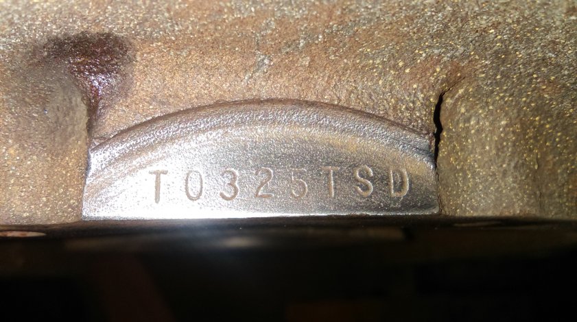

Block # 361958 Date C 4 78 2 bolt main
suffix code T6F724927
Heads 346236 Date A 20 76 and I 13 74

Anyone have an idea on the suffix code ??

[/attach]

TSD comes back as a 75-77 454. Low hp version. Not really sure what else you need to know about it.

Does anyone know how to Decode this number
it is the one on the front pad
T6F724927
Thanks
Scientific wild ass guess:
T = engine built at Tonawanda, NY plant
6 = 1976
F = car or truck was built at Flint. MI plant
724927 = last six digits of vehicle VIN
