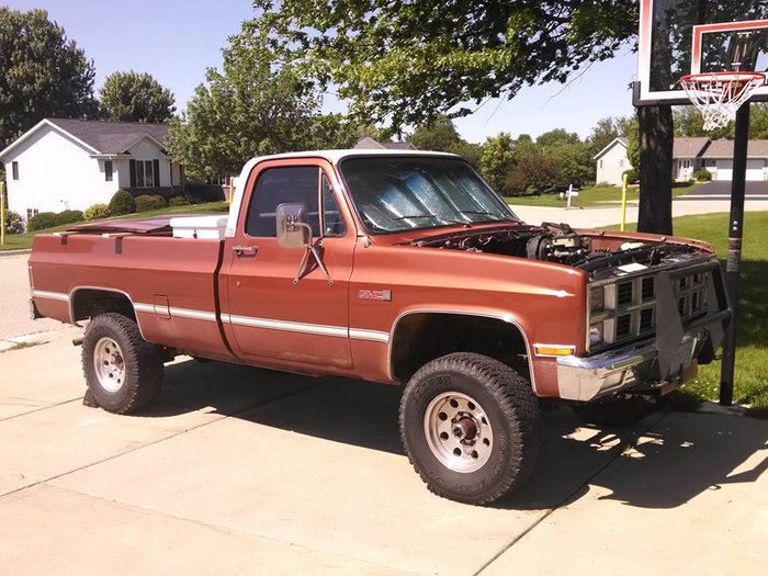

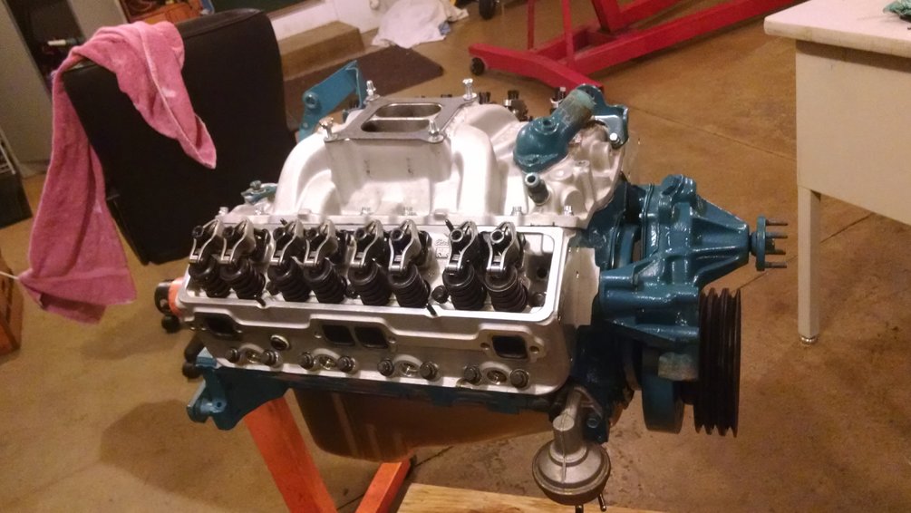

Hey, your build is similar to the motor i just built for my truck.
I used the 10120704 lunati Advertised Duration (Int/Exh): 276/284 Duration @ .050 233/241 Gross Valve Lift (Int/Exh): .504/.525LSA/ICL: 110/106
and couldn't be happier. 12 in of vacuum at 800 rpm, has a healthy sounding rough idle but is very snappy down low and pulls hard up past 6000 rpm no problem. Very liveable and I have been driving it to work for the past month 30 miles each way. Even got it up to 11.6 mpg the last two tanks and it would be better if I could keep my foot out of it.
Motor:
400 chevy .040 over zero decked and line honed two bolt block
Stock cast crank, Eagle 5.7 rods, Speed pro Hyper 12.5cc dish pistons
balanced rotating assembly, lunati 10120704 cam, 65cc 195 cfm Performer RPM heads, Performer RPM intake, 600cfm Edlebrock, comp roller tip rockers, 10.5:1 compression and runs well on 93 octane.
Truck:
82 GMC K2500 with an SM465, 3:42 gears and 285/75/16 tires. Thorley tri Y headers into Hooker 2 1/4" exhaust with flowmaster 40's.
Yeah, the SM465 is like a grain truck trans but at least you know you'll never break it. Shifts can be reasonable swift if you are used to driving it. The gear spreads on it are what suck for performance. Still plenty fun to drive though.

So I just got the truck going tonight finally. Skoots pretty good until ya gotta shift... the 4 speed is a good upgrade for now since the old th350 was getting weak. Hopefully a nice th400 with gear vendors od is in the future. Happy so far with the truck. It sounds great too.
Btw. Great cam for the motor. Lots of instant tq.
