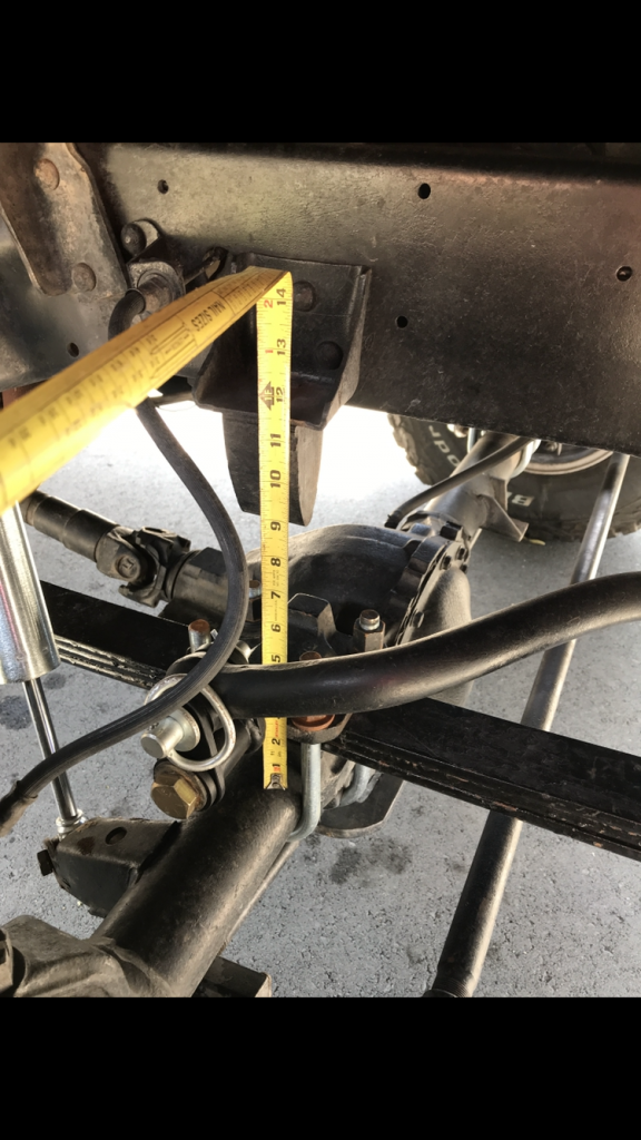

Do you have stock and aux mounts?
I went from duals to single 5125’s I have a 3 1/2” lift
Top of axle tube to bump stop mount is 12” stock is 8 1/2”

This is how to measure
My old TC 2” springs lifted my front 3”

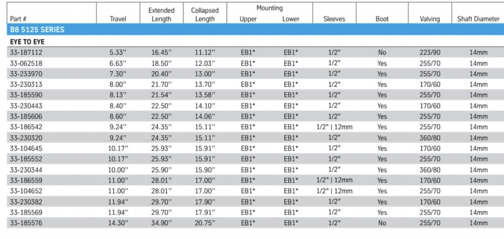

One of these should work 5125 series
33-185590
21.5” ext
13.5 collapsed
8.1” travel
255/70 valving
33-230320
24” ext
15” collapsed
9 1/4” travel
360/80 valving
33-104652
28” ext
17” collapsed
11” travel
255/70 valving
33-230344
26” ext
16” collapsed
10” travel
360/80 valving
89GMCJimmy
Mar 5, 2019
101
61
90245
ivan
Jimmy
Sorry Just realized you have a k20 not sure what standard is but this might help
