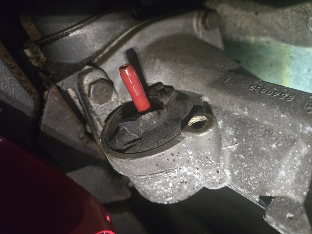

Speedometer not working. I checked the cable and it's fine. I took the bolt and clip off. Noticed one tab broke off already but when I tried to remove the sleeve the rest broke off. I'm guessing the only thing to do is bust it out and replace. Any tips for getting this out?

Maybe a Bearing seal puller.
Or a slide hammer with the hook end.
Pull off the extension housing then remove it from the inside.
