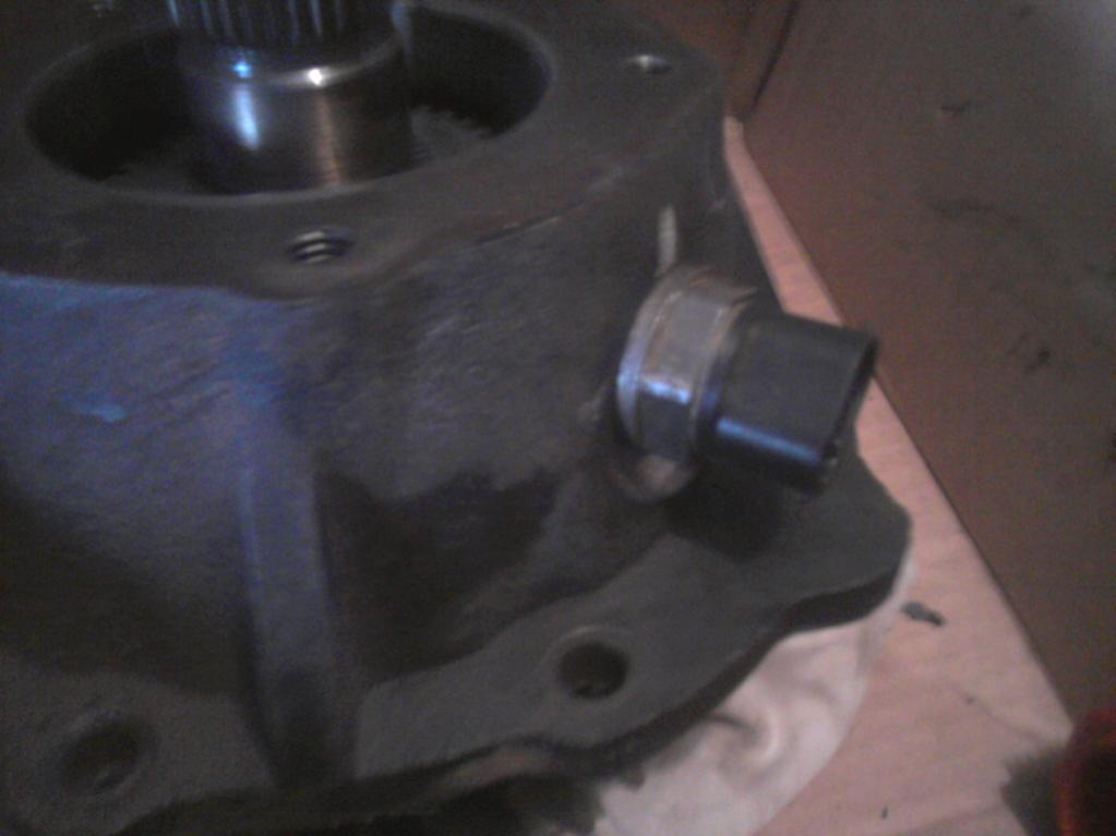

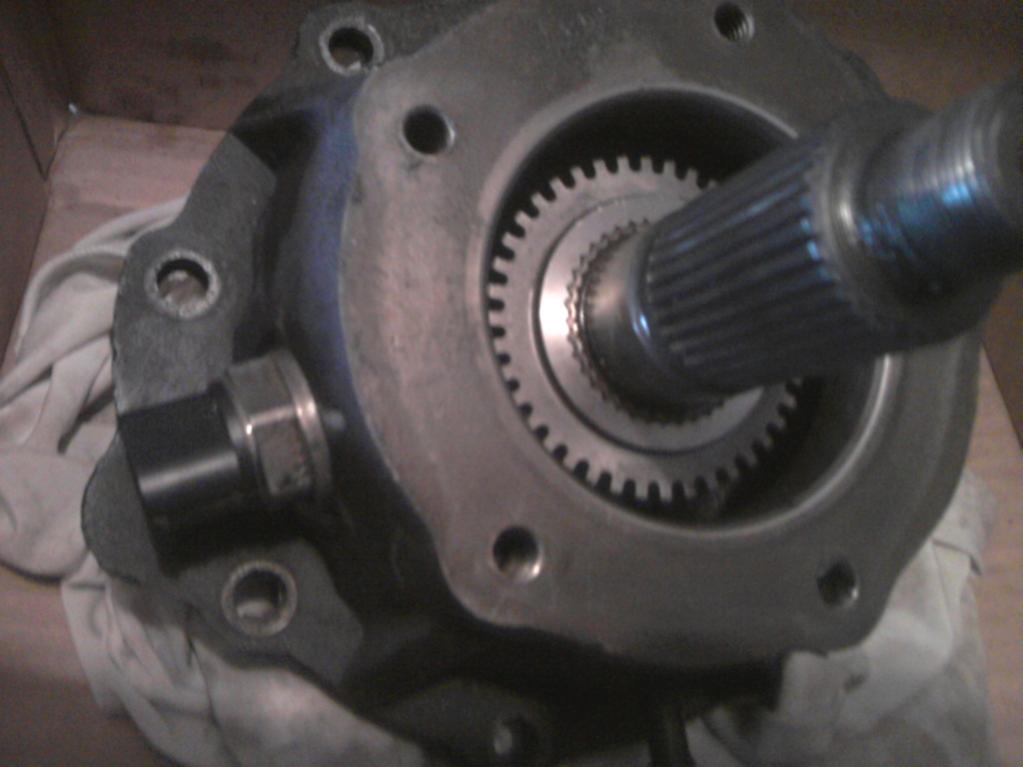

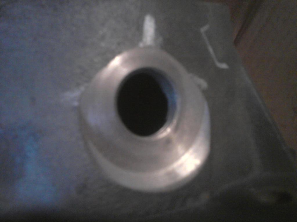

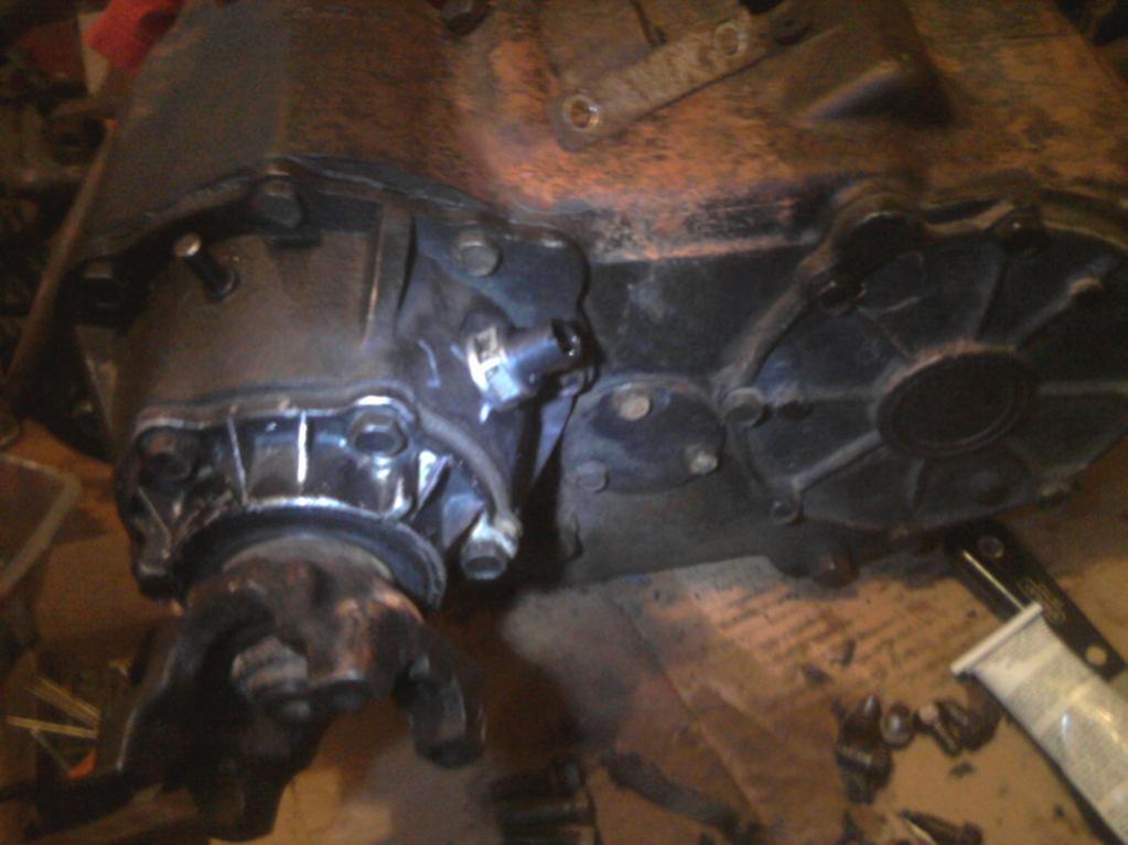

the machine shop got it done it worked out great
241 reluctor ring and sensor

so to recap
i used a reluctor ring and sensor from a 241
the reluctor ring needed to be trimmed to the same width as the speedo drive gear.
and i had a local machine shop machine the flat spot and drill and tap the hole.
the flat spot sets the gap between the sensor and the reluctor ring. the gap should be .010 to .012.
the speedo cable hloe needs to be pluged
i got the reluctor ring and sensor for free so all that this cost me was 75 bucks for the machine work.
